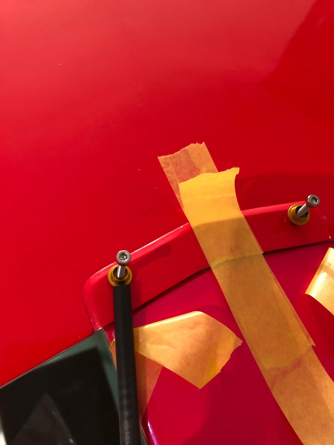

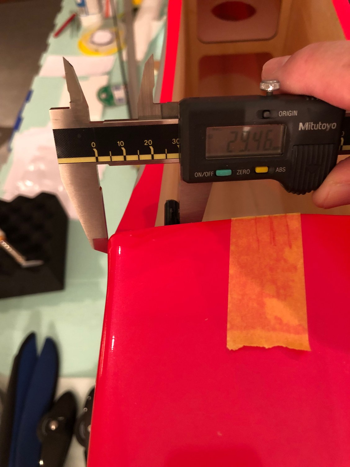

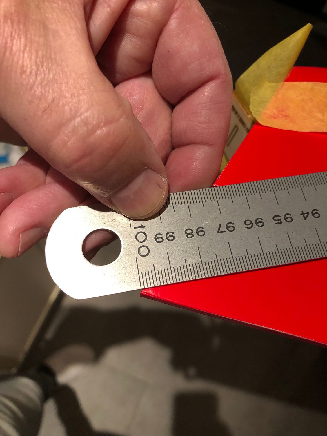

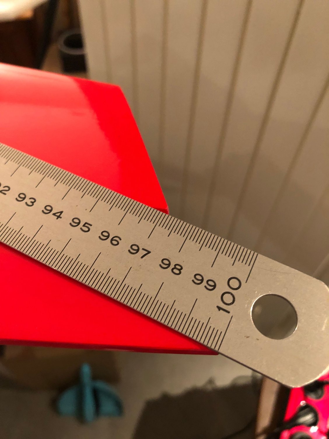

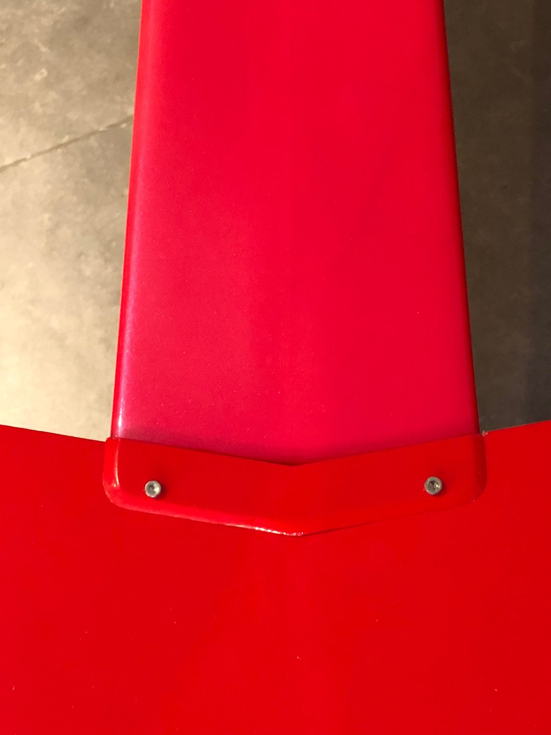

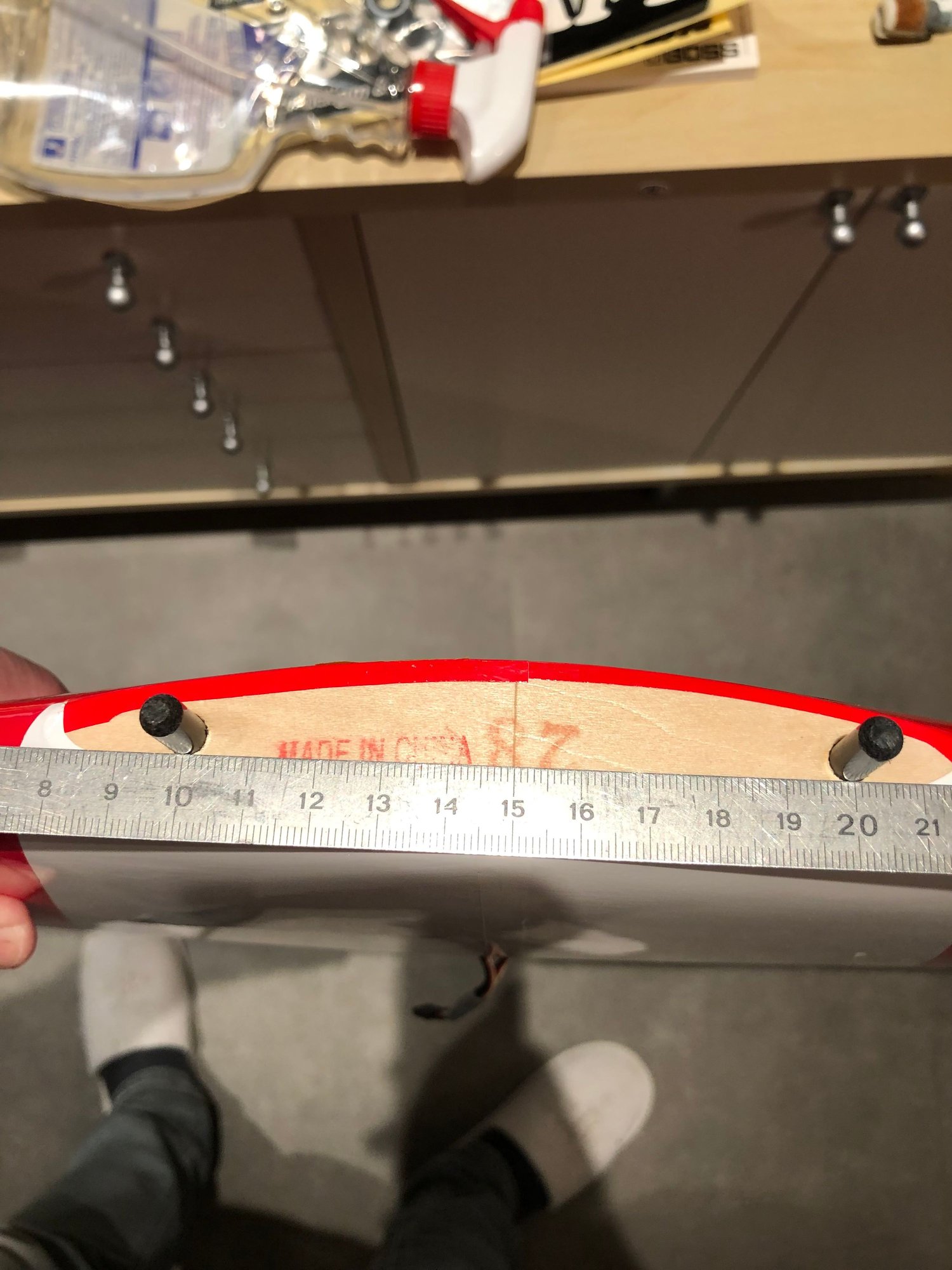

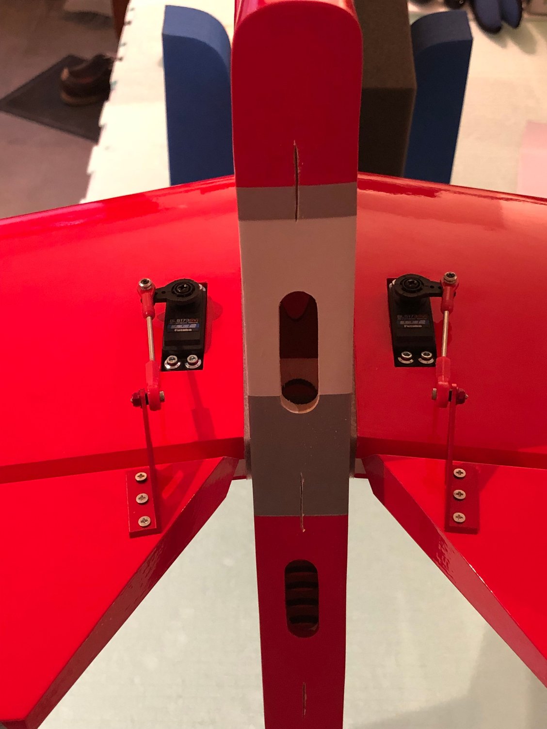

Installation of the bottom wing

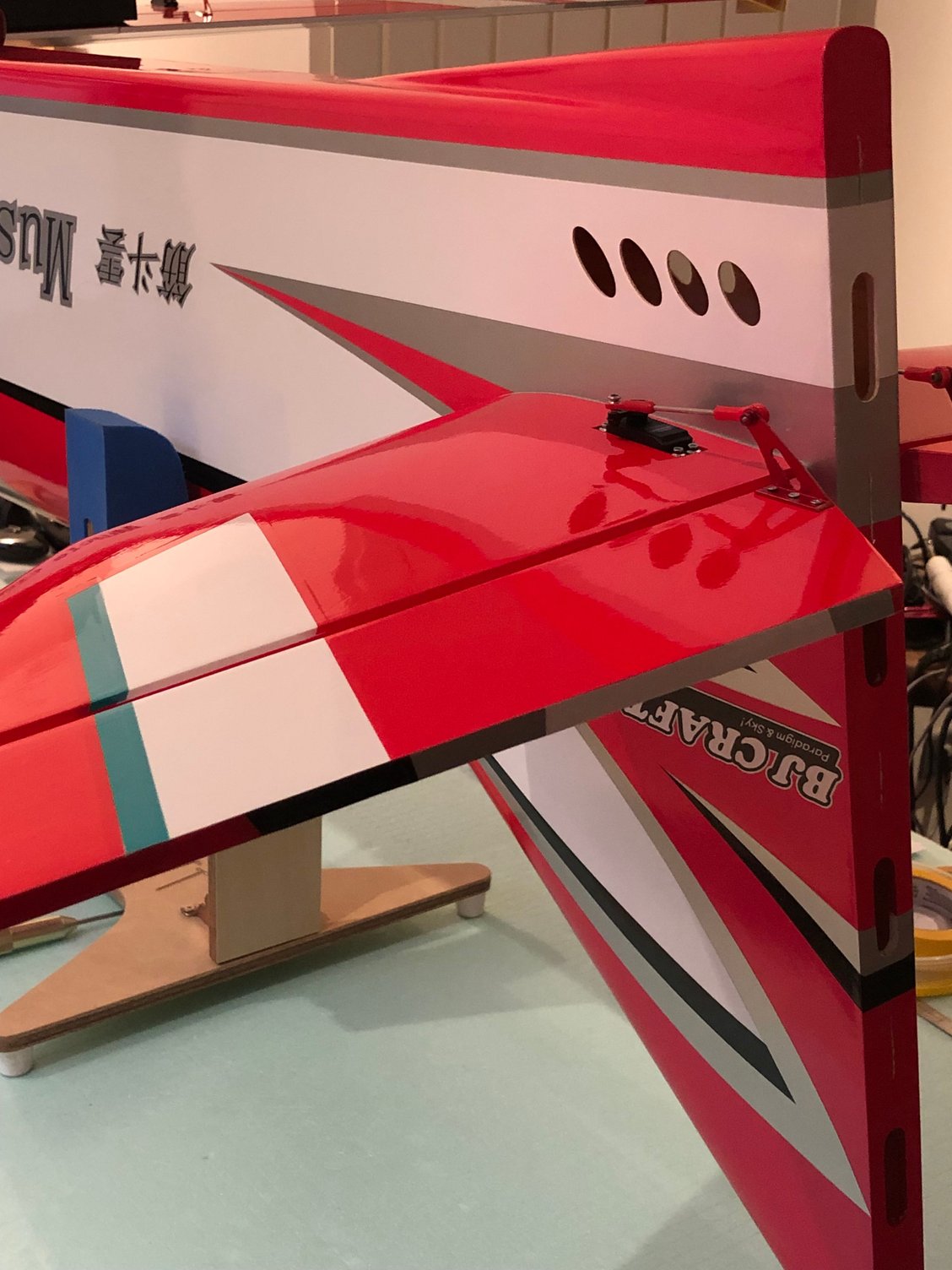

I started by checking the location of the wing dowels and retaining screws on the fuselage.
As everything is done by CNC, this is perfect

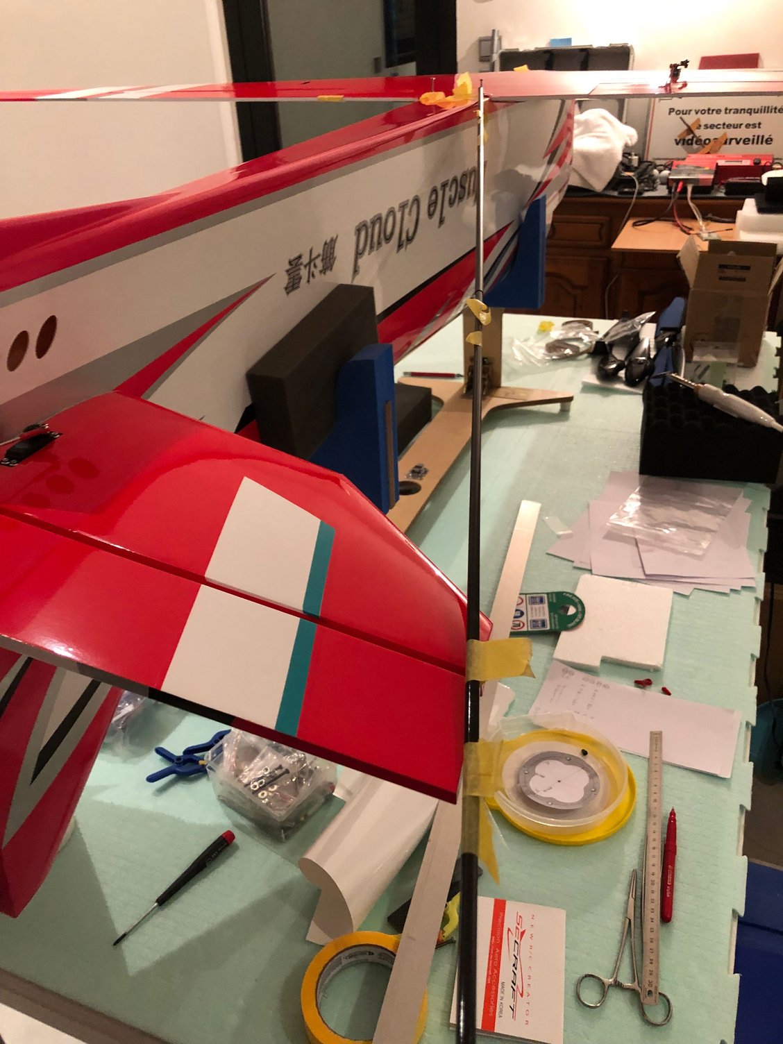

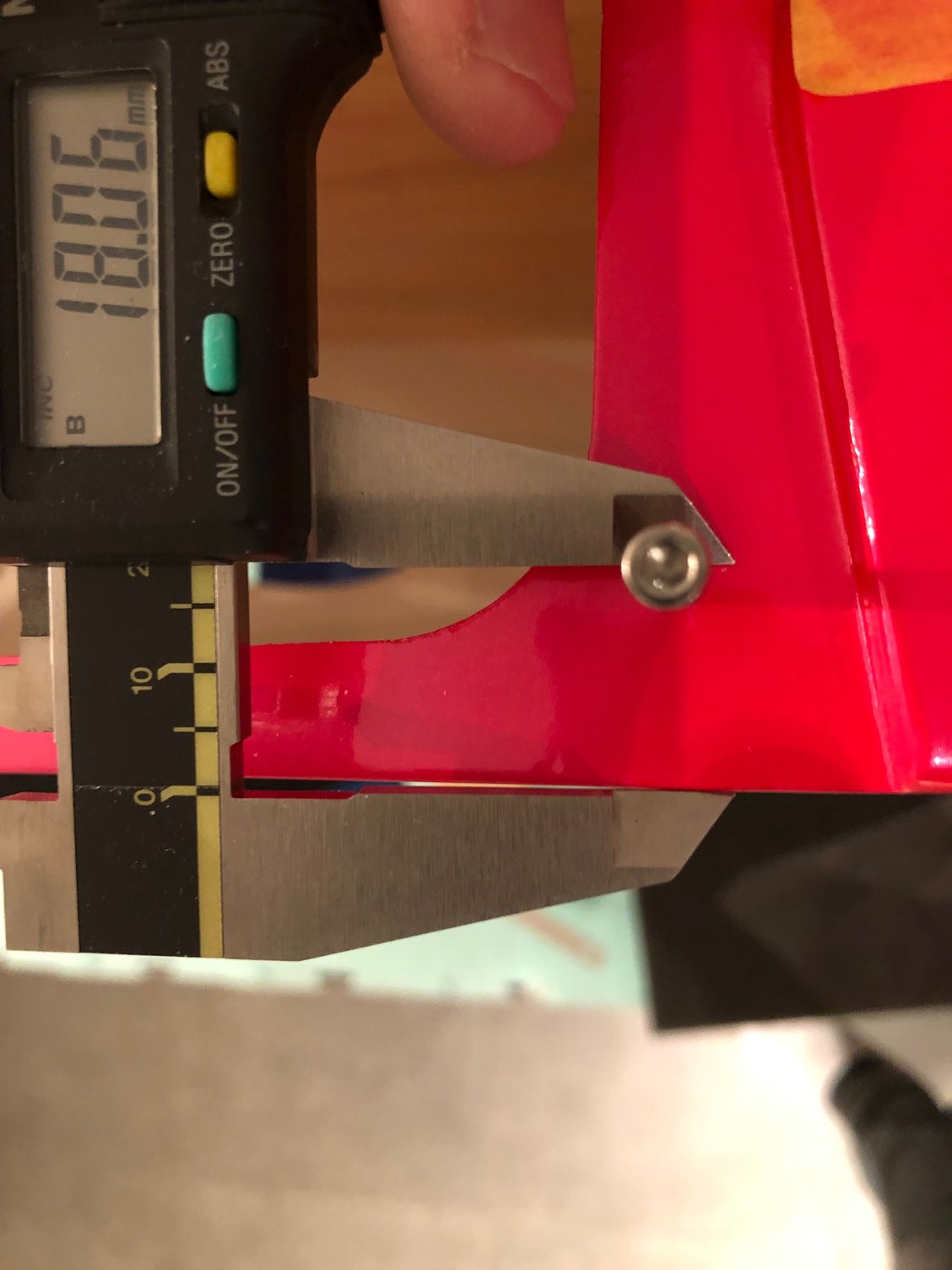

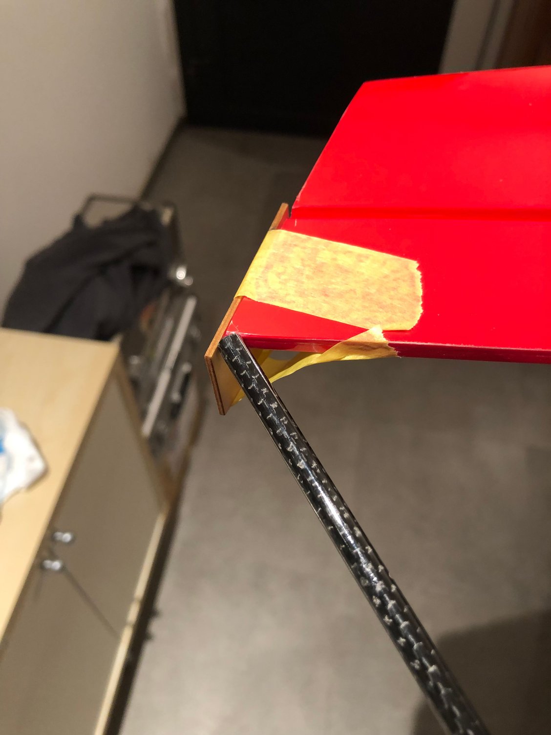

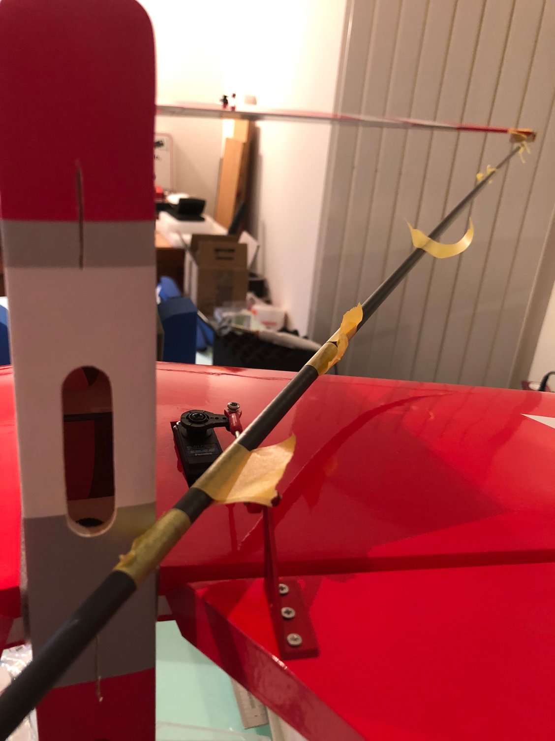

I installed the stabs and checked an equal distance from the wing bolts to the stabs tips
I use two carbon rods to check the equal lengths
Positioning of the stabs is perfect

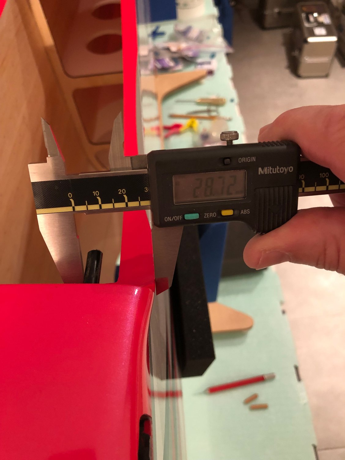

Then I checked the position of the wings, tips to fuselage, tips to leg plate, tips to stabs tips before drilling the trailing edge wing and installing the plywood insuring the right positioning of the bottom wing
All square.
The wings are the same as the ULTIMATE BISIDE, and you can read STEVE HANNAH comment's here
BJ Craft Ultimate Biside Build
