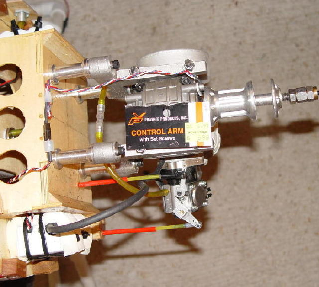

Fancman, the throttle and choke push rods you show in the photo look like metal. If they are, your asking for trouble like R. F. I.
You need to do it this way. Notice the non-conductive yellow plastic inner push rod.
