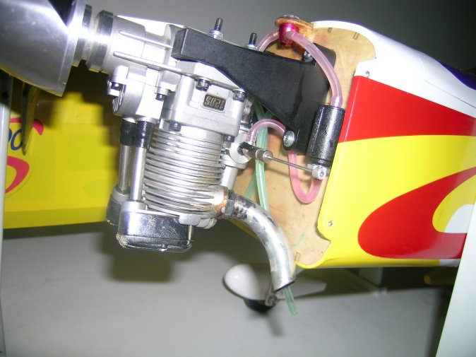

as we also found out installation of the saito 120 is no joke, either make a 90 deg coupler or use perri pump and dump the tank pressurization.
there is a thread over such an installation. you can see in the following photo ours.
also we found that APC 16x4W is better for torque roll and hovering, definitely not 16x8.
