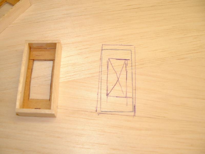

Wing servo box installation
The servo mount is made from 1/8" hard plywood. The mount is framed with 1/8" balsa. The Genesis kit already has the locations for the wing servos indicated on the wing skins. The foam is routered out with a Dremmel. I just mix up some thinned 30 min epoxy and microbaloon to make a paste to glue in the wing servo box.
