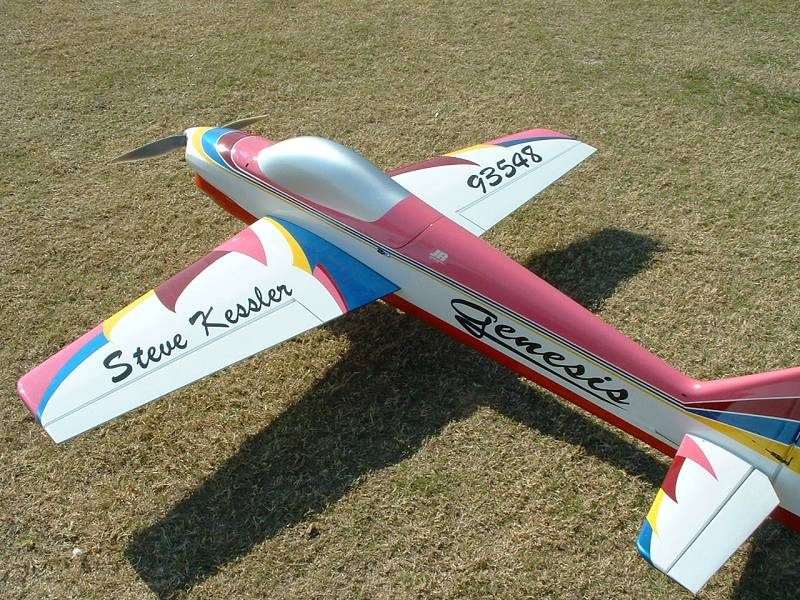

Here is the newly finished #2 Genesis
I had two weeks vacation over the holidays. Here are some photos of the newly completed #2 Genesis. I changed the color scheme on the wings and stabs. The plane weighs 10#-9oz with the Hacker C50-14XL motor, APC 22-12e prop, Acro 90 ESC, TP5300 batteries and a 1700ma NiMh Rx battery. The first two test flights were great. It flies the same as #1. I hope to have better winds tomorrow and get in some serious practice.
