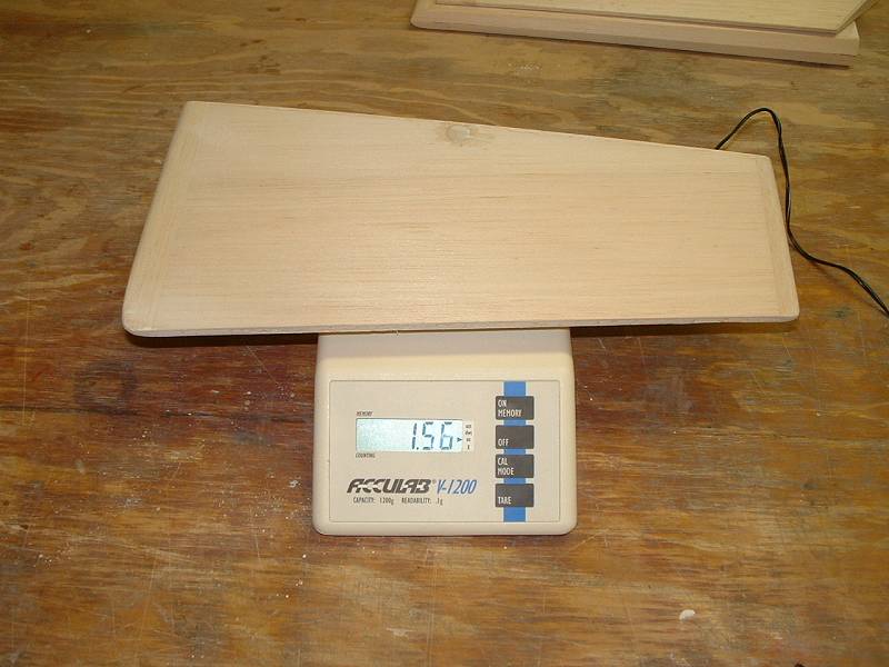

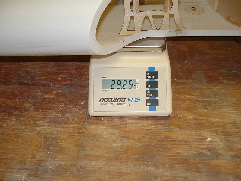

Build weights
The building phase of the plane is finished. Let's see how much weight was added. The weights listed in bold (xxx) are before paint and monokote.
Fuse 21.71oz (29.25)
Canopy 4.37 (4.86)
Cowl 3.11 (3.21)
Total 29.2oz (37.32)
Rudder .98oz (no LE installed) (1.56)
R stab 1.39oz (no LE installed) (2.30)
L stab 1.32 (2.23)
R wing 7.82oz (no LE installed) (10.53)
L wing 7.85 (10.53)
wheel pants 1.3 (1.6)
alum gear 4.8 (will use the Bolly CF gear)
PBG 7/8"x30" 2.6 (will use this CF wing tube instead of the aluminum)
PBG 7/16" 0.7oz approx. (will use the PBG CF tube instead of the aluminum)
