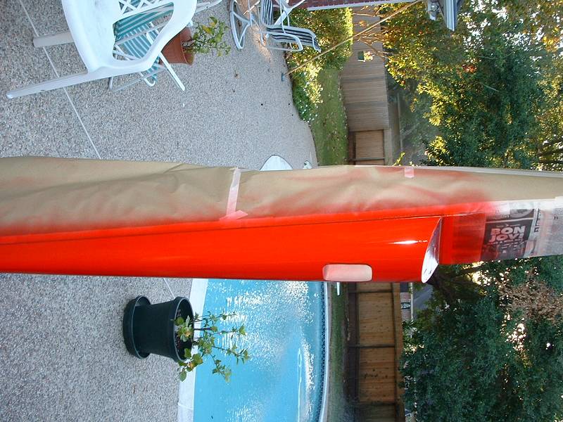

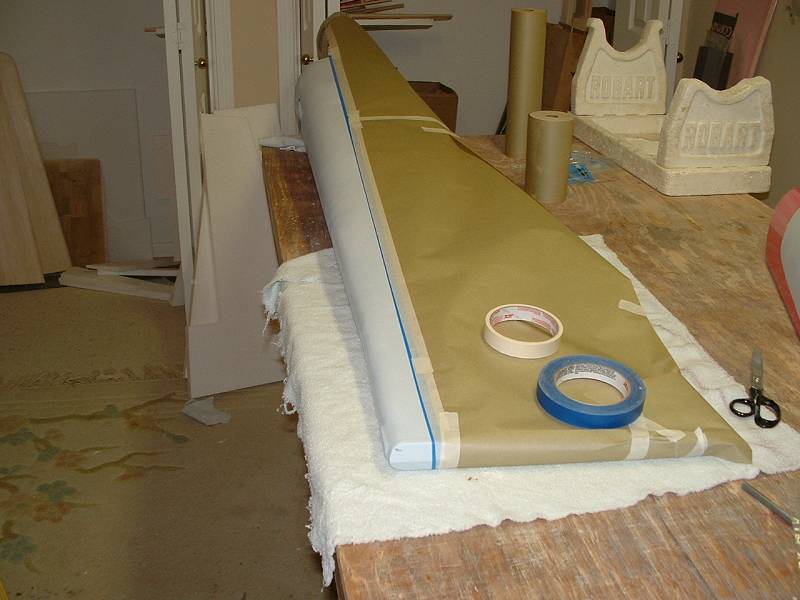

Painting tips
I have two types of paints. My white, pink. metallic blue and insignia blue colors are PPG concept. They match my monokote colors very well. My true red, yellow and maroon colors are Dupont Imron. I have had these colors for over 10 years. I simply keep the cans sealed well and they have lasted.
Caution Both paints are toxic; Imron being the worst of the two. My paint jobber recommends painting with a fresh air mask. Since I only have a chemical cartridge mask, I paint outside in the open air. I only mix small amounts and use a detail small touch-up HVLP gun. I turn the gun down as low as I can go and still get good paint coverage. Thin the paint and apply two coats if required. For small trim colors, I use an air brush. I try and keep the overspray to a minimum. Don't breath any overspray fumes. Also, I don't let the dog outside when I am painting.
I let the paint dry for 15 to 30 minutes and then remove the masking tape and paper. This is the time it takes for the paint to tack, but not dry. This allows the paint seam to blend with the fuse better.
Attached are some pictures of my masking and painting of the red trim color. Good luck.
