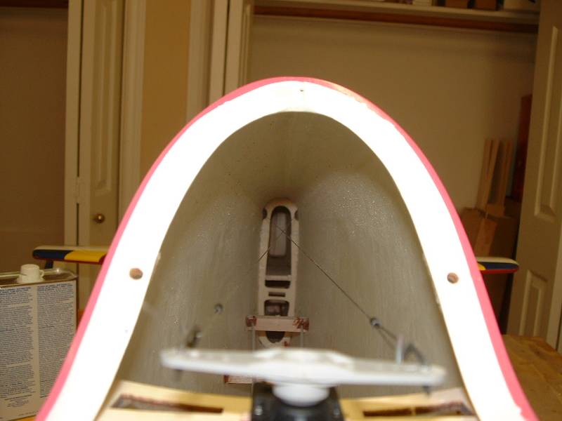

Rudder cable and battery installation
On the Genesis, it is best to cross the rudder cables as this gives a straight shot to the rudder. The battery is the TP6000 Gen II lites. I simply used honeycore material to fabricate a support tray.
