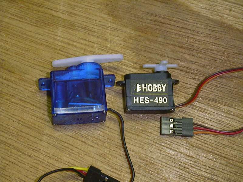

Excellent Wind, These photos will help immensely. I checked with H-L today, my Nippy and Li-Poly's are on the way. With a little luck I hope to get that delivery tomorrow, if so I will start building this weekend. I have been reviewing the instructions and have a question. I have the Edge like yours, On slide 8 in the instructions there is a difference in measurement for the edge to the extra. What does that measurement refer too? Are those marks for wing location? Also I see you centered the Aluminums tube, did you make that cut before or after you built the fuse?
I have tons of Q's, my local hobby shop guy claims this is a tough plane to build. His buddy has built 5 and says it still takes him approx 6 hours. I have been warned it is easy to F*** up when building this kit. ALSO!!! can I fly my Nippy setup with a 3 cell Lipoly?(340mAh) I bought 2 cell packs but My local Hobby guy bought 3 cell packs. (i'm just tying to keep up with the Jone's)
Here is a shot of a Hobby Electronics sub micro next to a Hitec 55. Check out the size difference. I'll report back with the weight soon

Zibob, I would think the Hitec 55's would be a better chioce. I will be trying the Hobby Electronics HE 490 servo on my shocky I just posted a comparison photo. I got them from Bob at Balsapr.com.

Neat little servo. Must be cheaper than the Cirrus, I bet.

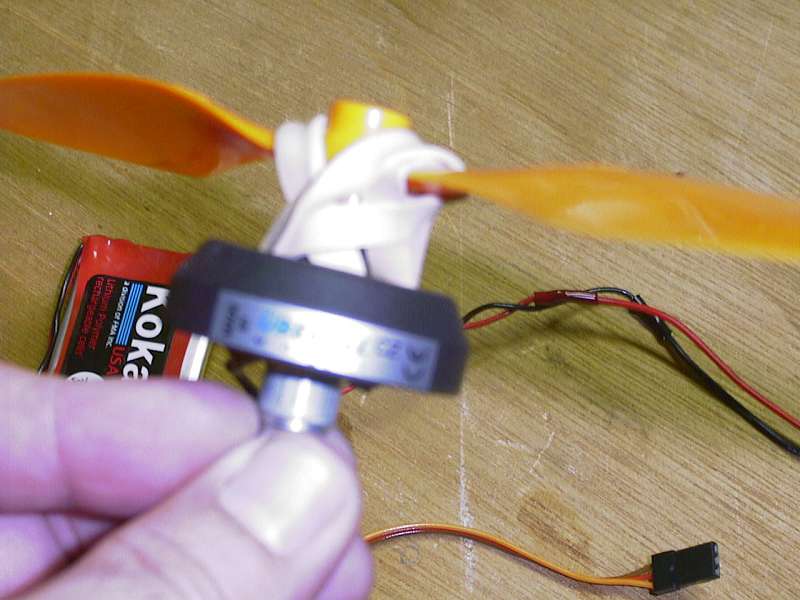

Here is tonights question; how do you correctly rout the rubberband that holds the prop on?
I'll snap a photo of my setup you have to see my goofy rubberband job
Whack!

#42
Seb,
I posted this thread for my E-sledge that shows the nippy rubber band prop saver:
http://www.rcuniverse.com/forum/m_14...tm.htm#1487876
These photos show what I did with the #64 rubber band:
http://www.rcuniverse.com/forum/upfi...78/Wu61484.jpg
http://www.rcuniverse.com/forum/upfi...78/Pn36686.jpg
Note, I did not drill out the APC prop for this. I used a small piece of brass tube to make up the spacer difference between the motor shaft and one of the stock APC slow flyer spacers. This way there is some room for the prop to move when it hits something. One of the above pics shows the prop snapped to the side so you can see the hub.

Hey wind, I blew off work today to get the tube setup ready. I ran to 3 hobby shops and could not find thin wall 7/16!QUOT! aluminum tube. Finally I went to Home Depot and found 1/2!QUOT! ID thick wall tubing just over 7/16!QUOT! OD. I tried to Swedge a flange with a Special tool which didn't work, So I rheemed the tubing out to fit the Nippster. I am using a JB Weld type of polymer epoxy to fit the !QUOT!snug!QUOT! flange. I'll drill and tap it tomorrow. Saturday will be the day I assemble my shocky since I now have absolutely everything I need.
What would this post be without a few more questions!!!
Is there a special tool for removing and replacing the 4mm E clips?
Is it imperative to remove the hub from the windings?
to clarify, is there only 1 #64 rubber band both ends fished through?
What size bronze tubing are you using for your prop shaft adapter?

I can't imagine threading the rubber band without removing the windings. Let me know if you try and succeed. It's pretty simple to remove and replace. Just don't lose the e-clip. The rubber band seems to last forever, and you don't need to re-thread it every time to replace a prop if you use the old one to carefully thread the new one through the loops.
Only 1 #64 rubber band, correct.
Not really sure on the size of the tube, but it is brass, not bronze. The OD is 0.186" -- also a K&S part. It might be 3/16" telescoping tubing. You seem to be a machinst type. I'm sure you can get something to fit.

So Wind, before I hit the sack last night I fished a #64 rubberband through the motor holes and banded the prop on like you have shown me in your pictures. It took a little ingenuity but It seems top be less archaic than the my first banding attempt. My aluminum motor mount is looking real good, I forgot how to post photos (and I'm not home right now) or I would show you my handywork.
Making the tube took some effort but the weight benefit is outstanding.
Kid are you using ASTRO MOTORS right now? how about posting some photos.
I figured the photo thing out, this shot is my first attempt at banding a prop onto the Nippy
I will have to look into the Astro motors. I know they have been around for awhile. I am looking for more power for my FLITTERB.

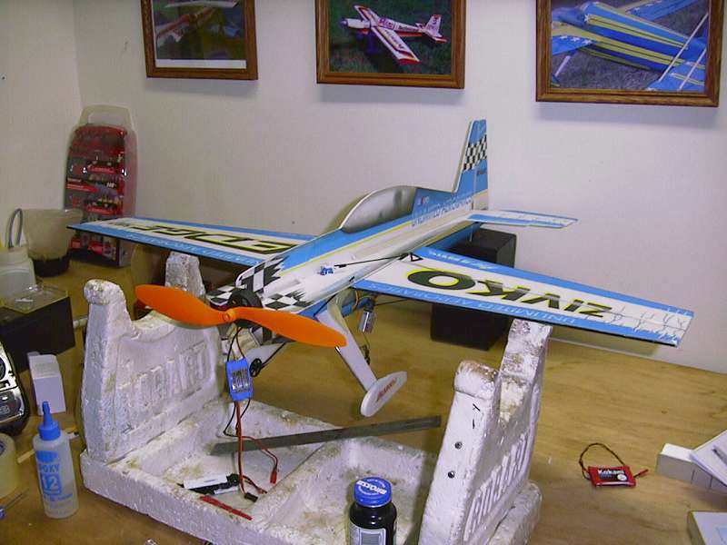

I spent the day building my Shocky. It took 8 hours total time but I was out of 5 minuet epoxy so I had to use 30 minuet. I went a bit light on the hardener and the epoxy is still a bit soft. Here is a shot of the plane.

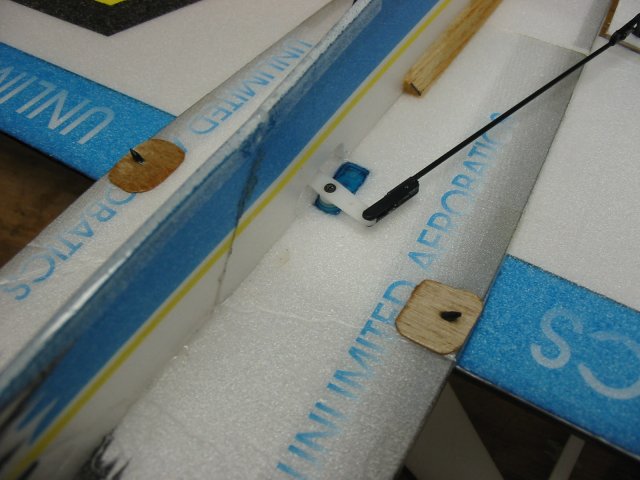

Thanks Dude, it was kind of fun to put together. I have been building all sorts of kits for more than 20 years. When I first started back in high school my dream was to be able to fly aerobatics in my living room or basement. This plane brings me one step closer.
I messed up the rubber gromet for the landing gear. I was thinking about using GOOP for this area. I can also wrap it up with some carbon fiber stran material or use probond.
Did you run out of glue when you were building your ShockFlyer? Luckily I had some rubber cement on the shelf.
I didn't do a good job hinging the surfaces either. the alerons are not flush with the wing. I will look fo a clear 2 sided tape or better way to hinge the surfaces. I doubt my job will effect the way it flies.
I didn't use enough hardener in the epoxy and it is still a bit soft, I may have to encapselate that in some more epoxy. I think I can afford the overall weight gain due to the very light motor tube and those really tiny servos I used for the tailfeathers.
Once my epoxy hardens I will give her a test fly. I'll keep you posted!
By the way!!! what does the subject of this stream mean. Shockflyer Acc??? I'm just curious
