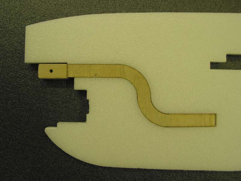

Old 09-09-2004 | 08:09 PM
tashley's Avatar
Joined: Apr 2003
Posts: 1,339
From: Manvel, TX
Default RE: 3D Foamy

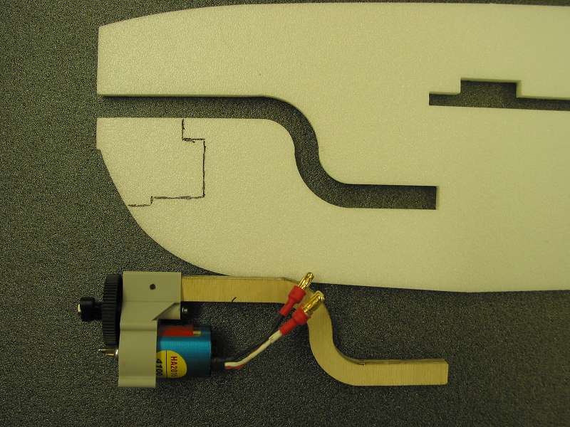

My work started with the lamination of the motor mount/nose brace and the layout for the motor cut out in the nose. The motor I chose for this project is a Himax 2015-4100/GWS EPS gearbox with "D" gearing. Epoxy was used on the motor mount.

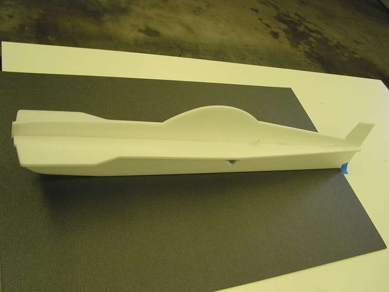

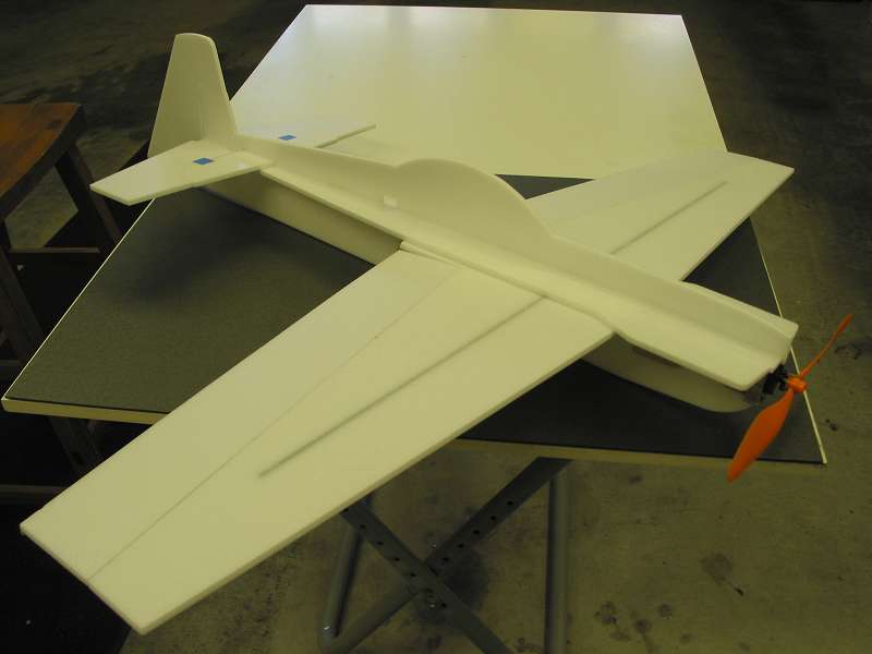

The fuselage parts were fitted and joined. A unique feature I found all through this kit was the extra tight fit of all the parts. I like having the option of fine fitting the parts of a model instead of having to figure out the best way of filling in sloppy fitting parts with extra glue and weight.

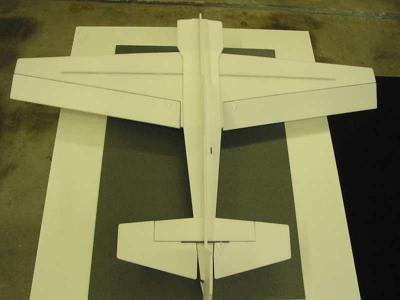

Old 09-09-2004 | 08:57 PM
tashley's Avatar
Joined: Apr 2003
Posts: 1,339
From: Manvel, TX

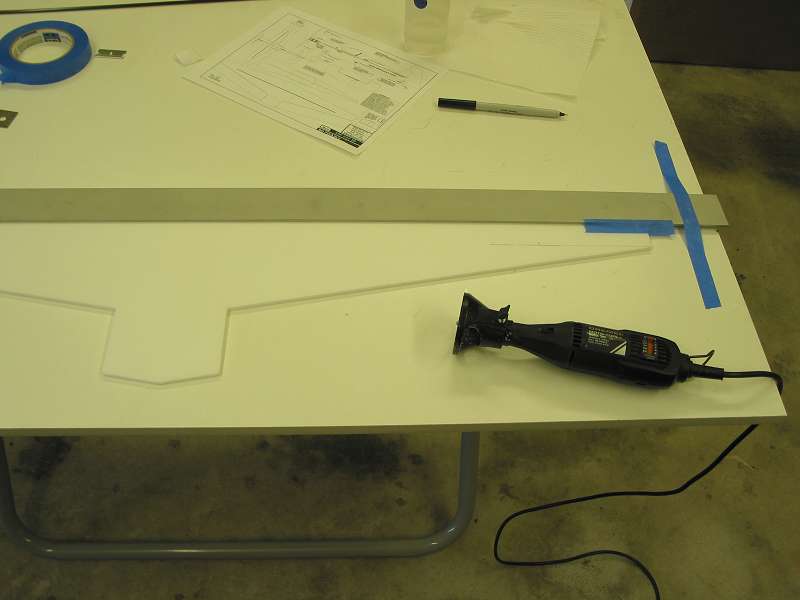

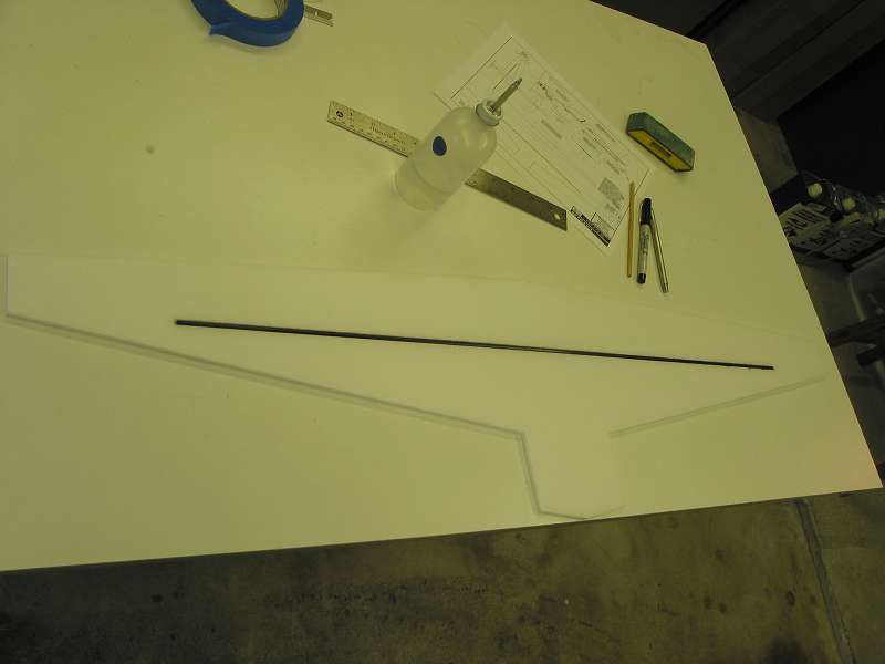

Here I'm setting up the wing to cut the groove on the bottom side for the included tubular graphite spar. I use a Dremel with base and 3/16" router bit. You just lay out the location as shown on the plans, tape down a straightedge, and guide the tool along. Easy and neat. Much better than cutting a groove with and Exacto knife. Another shot shows the finished job. I've used every known adhesive on foamies and what I'm happy with now is to tack glue, if needed, with foam safe ca and then glue with Formula 56 canopy glue. I holds like mad and unlike ca it will flex without cracking.

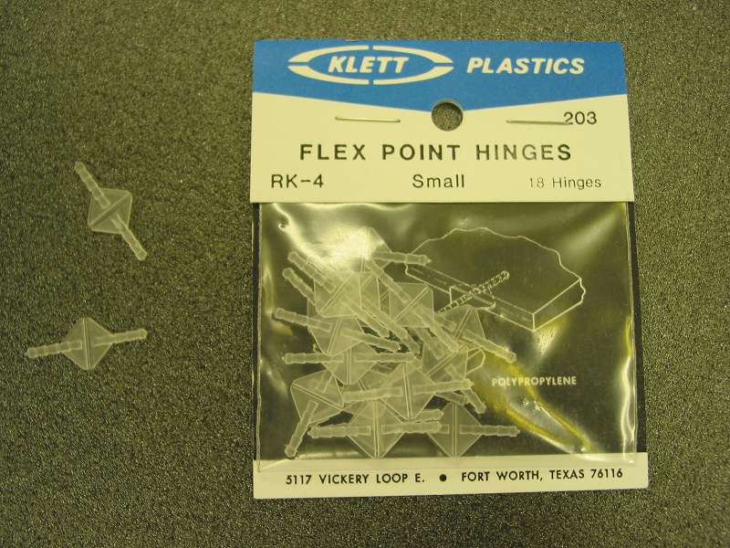

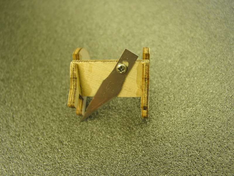

With all the parts mocked up I'm now ready to start the hingeing operation. You get a nifty little tool with the kit. A control surface beveling tool. I'ts all laser cut as well, just glue it up, install a number 11 blade, and get after it. Cool!
Also shown is my hinge of choice. I use the canopy glue on these as well.

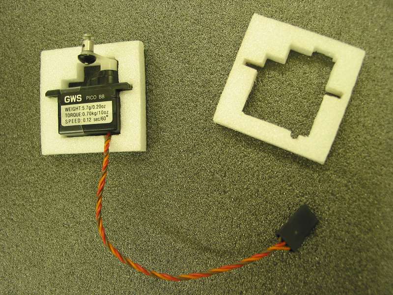

Old 09-09-2004 | 09:21 PM
tashley's Avatar
Joined: Apr 2003
Posts: 1,339
From: Manvel, TX
Here's another cool little feature included in the 3D Foamy kits, servo corrals for the aileron servos. It really dresses up the servos. Glue them at the proper location and use servo tape on the servos.

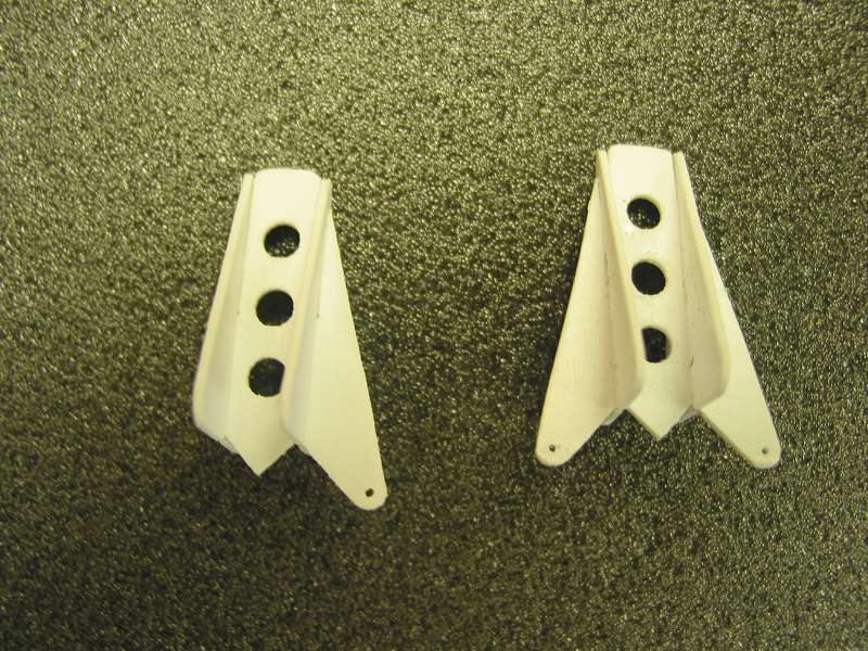

Old 09-09-2004 | 09:31 PM
tashley's Avatar
Joined: Apr 2003
Posts: 1,339
From: Manvel, TX
A shot of the included control horns. All control surfaces have a laser cut slot to glue the horns into.

Everything is all fitted and glued and it's time to head to the paint shop for some color and flash. I'll be back soon with some finished pictures and a flying report.
If you haven't already done so you can check out the place to get one of many different 3D kits[link=http://www.3dfoamy.com/] here.[/link] Lots of very cool stuff.
These kits can be built in a single evening they are so well engineered, and I'm sure that the Cap will perform as well as the other 3D Foamy planes I've built.

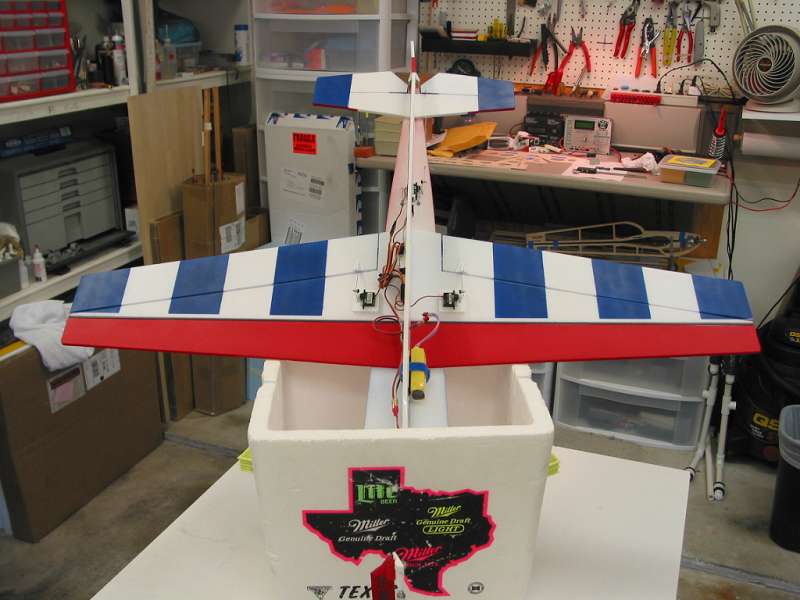

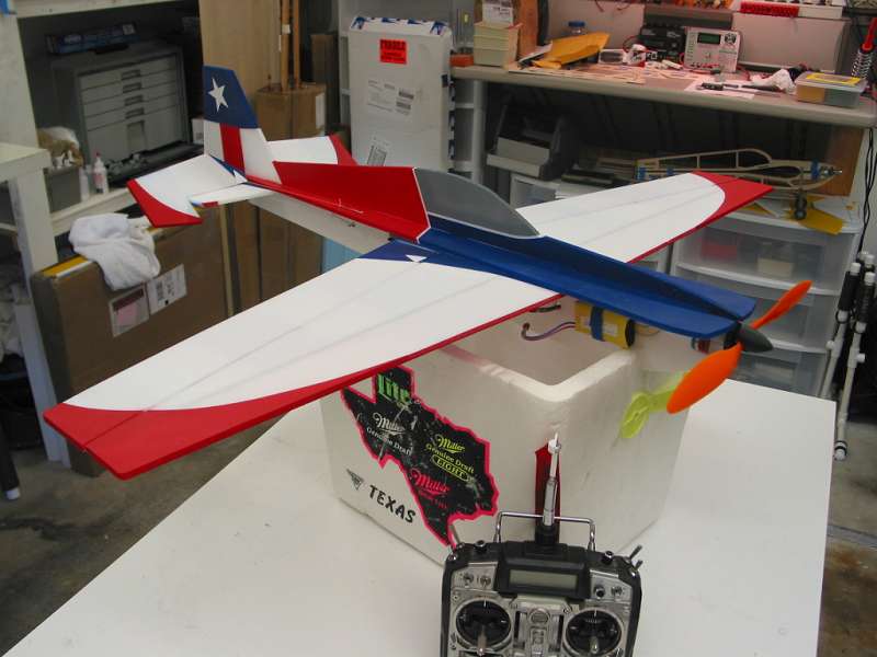

I'm sorry to say that I ruined the Cap trying a new painting technique which is why I have taken so long to finish this 3D Foamy build thread so...I did the only sensible thing, I built an Extra. Here are some shots of the finished model taken after the first flight. I know, you're supposed to take pictures first in case the plane dosen't survive the shake down flight. The deal is, I have so much faith in Levi's designs, having built a few before that I was assured sucess. The Extra flys maybe a tad better than the others I've tried, or maybe it's just the red white and blue scheme which stands for so much. I'll be back shortly with some action shots. Dang these foamies are fun.

Old 09-19-2004 | 04:29 PM
tashley's Avatar
Joined: Apr 2003
Posts: 1,339
From: Manvel, TX
I don't know why the color came out looking so yucky in the posted pics. The scheme really does look better in real life.
Old 09-19-2004 | 08:56 PM
MikeEast's Avatar
Joined: Oct 2003
Posts: 3,246
From: Nederland, TX
Dang I love it so much Im going to copy it on my next plane if you dont mind!??
