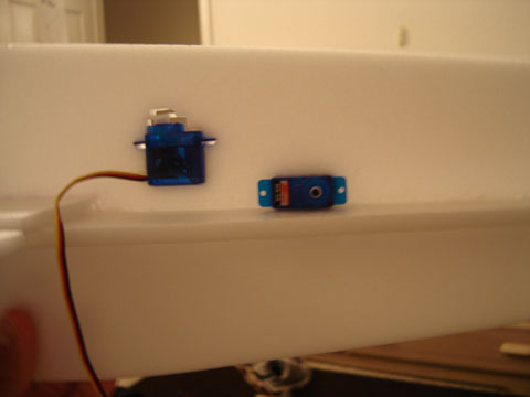

Here are a few photos of the airplane as it sits right now. There is a photo of the elevator servo and what I am trying to figure out with the pull/pull system...are you supposed to cut the horizontal part of the fuselage up or...?
Thanks for the help!!
Adam

you'll need to cut a small slot for the servo arm to move through... Looking great!

Thanks Levi! Thats what I thought, but the stock HS55 servo arm (the longest one) just barely seems to be longer than the surface of the depron...do I need a larger servo arm?
-Adam

Nope.. It'll be just fine. mine is the same way (BMS.371) If you want to you can move the servo up into the cross section... but it's extra work and not realy needed.
