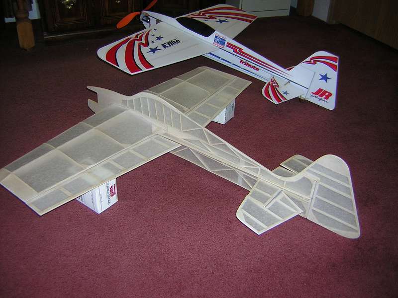

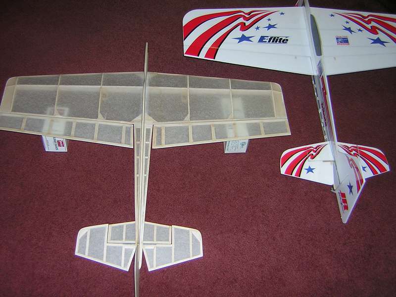

[img][/img]Liked the foam trib so I thought i'd try a balsa version. Got it ready to paint now. I made the fuse & rudder a little bigger, and added the fuse side ribs. These weigh nothing but add tremendous strength. Plane so far is very light...

check the ballance of rudder area arround the thrust line or you will have more coupling

could you please explain your last post regarding the area of the rudder and the thrustline and the effect on coupling?

What the coupling refers to is when the rudder is deflected, depending on where the center of pressure of the rudder is, it will induce a rolling moment coupled with the pure yaw moment that the rudder should produce. The idea is to balance the rudder area above and below the roll axis of the aircraft, so there is no coupling. It can be all calculated with math, but he most common approach is trial & error.
