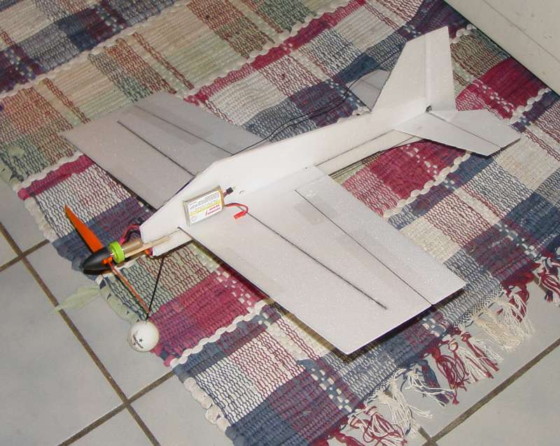

here is a pic of my new little lenny 3D
specs are
24 inch wing
24 inch long
power: 17 turn cdrom motor from lensrc
weight 5 oz
thrust 10 oz
full house controls, flies great. I'm not a 3d pilot and I am allready hovering for 4 or 5 seconds at a time sometimes longer. roll rate is terrific, hovers at half throttle or a little more, pulls out with awesome authority. so small it will go in any car.
anyone interested in a kit? what would be a resonable price to you guys? if shipping cost is reasonable would anyone be interested in an ARF version?
I also want to do some biplanes, maybe a 24 inch sopwith pup or a starduster.
I don't have plans yet but when I do I will let everyone know (plans will be free and in cad format)
any feedback is appreciated, thanks.
Jason

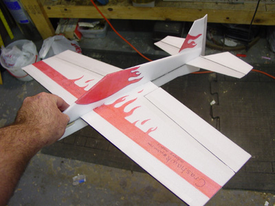

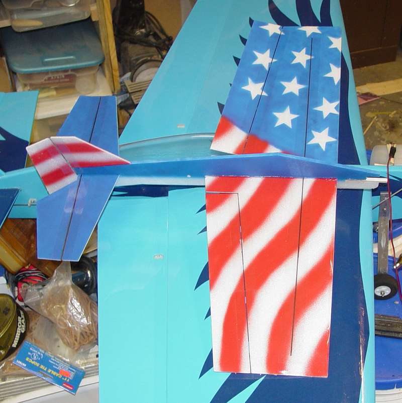

here are a couple more, would 40 dollars sound resonable for an arf version or 25 for a kit?
