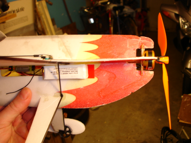

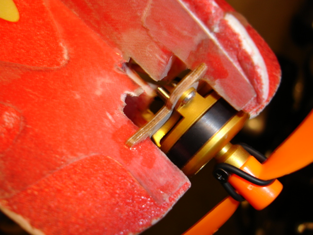

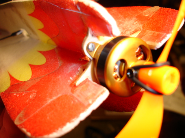

i got a edge 540 ikarus, and a axi motor, no idea how to mount! help! help! want to get flying, i think it has somehting to do with cutting back a hole in the mount area, or somehting, im confused, no idea, bad instructions! help! anyone!

Old 01-29-2005 | 09:55 AM
Ryan Nau's Avatar
My Feedback: (54)
Posts: 611
From: Williamstown, PA
Default RE: Which Shock Flyer is better?
Look at this. This will help you.
http://www.backyardflyer.com/click_t...04/shock_1.asp
http://www.hobby-lobby.com/shockflyer-brushless.htm

Posts: 7,816
Received 10 Likes on 10 Posts
From: Upplands Vasby, SWEDEN
Hi!
This is the way I mounted my AXI 2204/54 motor. 2mm plywood motor mount, epoxy glued in and thin sheets of 0.4mm glass fiber as stiffening up front.
Plane weights 150g using 2cell E-tec 450mAh Lipo.
Regards!
Jan K
