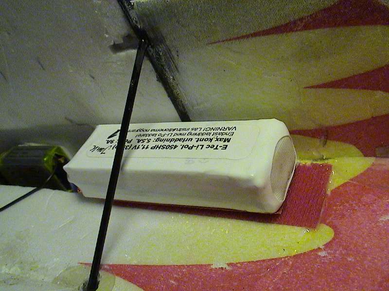

Hi everyone. Ive just built a Ikarus Extra shock flyer and was wondering if anyone out there who fly these things can give me some tips on how to store the lipo battery away in the slot under the wing???

i made a foam spacer and compression fit them in (extend the foam tward the wing )... but if you dont care about a gram here and a gram there then just velcro them in

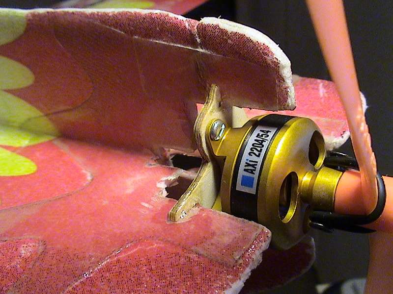

I got a ikarus shock edge 540, and i have no idea on how to install my axi engine. Can you send me any ideas or anything, cause im lost.l In the manual, it shows a diff engine, help. If you want to know the engine type just go to this link http://www.hobby-lobby.com/brushless-axi2208.htm

http://www.hobby-lobby.com/shockflyer-brushless.htm

alright, you are going to need to buy the radial mount for your motor, you can get it from hobby lobby. then, glue the plastic x shaped thing that comes with the shockflyer kit with some foam CA. now you are going to need a small piece of 1/8 inch light plywood cut into a diamond just big enought to fully cover the plastic "motor mount". then epoxy this wood "firewall" to the plastic motor mount and screw your radial mount for your axi to the wood.
kinda hard to explain, but i hope you get the point, it takes some immaginatoin...ill give ya a quike sketch to show ya what im talkin about...
**edit** ....or you could just do what the link he gave you says to do....^^^^

Scott. You might try clicking on the link that Wayne posted and print out the instructions. This is what I followed when mounting mine and it worked great. The only thing I did different was I ordered the mount from mjp carbon instead of cutting it out of plywood.

Hi!
Here is how did it on mine...batteri is a E-tech 450mAh 3cell Lipo.
The smallest AXI 2204/54 is definitely the engine to use on the Shocky and a 8x4,3 GWS or 8x3,8 APC. Do not mount it up front...then the model will be too front heavy! Larger AXI:s you will have to mount even further back!
Regards!
Jan K
Sweden
