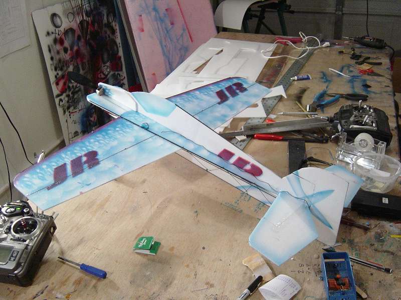

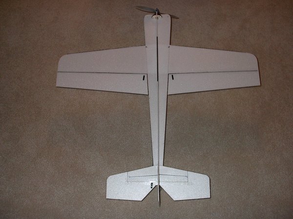

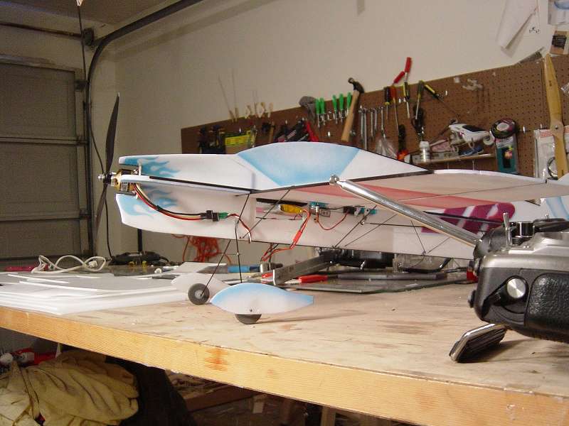

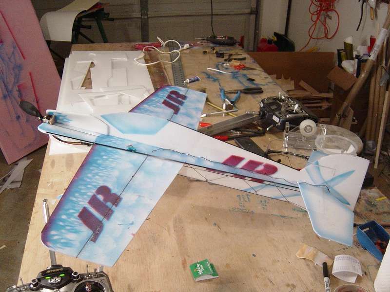

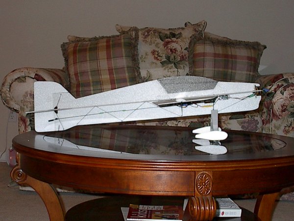

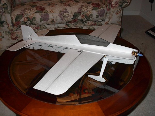

Jon Leyland designed this plane to first and foremost fly Precision .
Its awesome!
He calls it the Sobre'
I just finished mine.
Axi 2204/54
Phx 10
2 cell 720's

Looks good Wayne
Whena re we going to get a video.

Hey Wayne,
right up my alley. have you flown it yet. what are your impressions? I've been leaning bi-plane for some precision have you seen any of the F3A-I videos? impressive. anyhow, I have a 2208-34 and a phx 10 good combo? Im interested in plans
oh, yeh. that thing needs a kick ***** airbrush job!

Looks like an ExtraEdgeyGiles,,,
nice lines !

I havent decided what I am flying yet.
Hubb:
I havent flown this one but did fly Jon's original a few months back.
It was really cool. We were flying the 2004 Unlimited sequence with it.

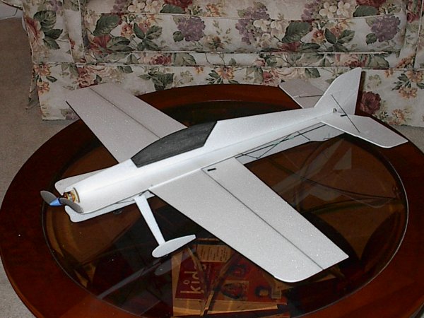

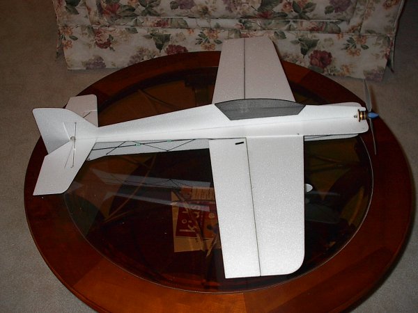

Here are some pics of the original sobre. Axi 2208/34. pheo 10. we use li-poly 860 mah 3 cell which gives it plenty of power. A 2 cell also works great. heres the pics.

Are they comming on the market or are there any plans for them ?
How much is the ready to fly weight ??

it is 6.8oz without batt. But that has a lot of carbon on it and we are making one right now with the smaller axi and hopefully get that around 5 oz without batt. I am not sure about putting it on the market or plans. But will try to do plans.

And you built this from fan board, or whatever the hell it is called. Freakin wow man, that plane is absolutely ridculous. This has changed what I thought an electric profile was capable of. wgeffon
Is there any way you could post a generic list of building materials. Not really equipment just building material. I am entertaining the Idea of building something similar.

The plane is made from 3mm Depron and has some carbon sticks on it for strength.
The rest is standard equpiment you'd use on a Shockflyer type of plane.
