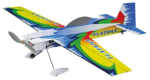

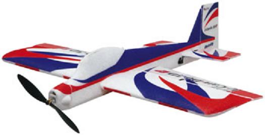

i have been flying glow for years and i just started to get into a little 3D flying when i bought my U-Can-Do 3D 60. i have flown many different electric planes and i am thinking of trying a 3D foamie.
these are the ones im considering right now but i am open to suggestion. the only "but" i have is that i dont want a brushless motor. i want to keep this thing fairly cheep because i bought too many planes over winter.
im looking at either the Great Planes Flatana.
http://www2.towerhobbies.com/cgi-bin...?&I=LXJTK0&P=0
the U-Can-Do 3D EP
http://www2.towerhobbies.com/cgi-bin...?&I=LXJPU8&P=0
im leaning toward the Flatana but if there are any other planes that come to mind please let me know.
thx EVOL

Saw the Flatana fly in Memphis at the EAC Indoor last month. Looked good. Saw the UCD fly (or attempt to fly) and was NOT impressed. From what I've read you should stay away from it.
Not sure how the Flatana (or the entire line of Flat-Outs for that matter) would do outdoors. It would have to be DEAD calm, b/c they are so lite.

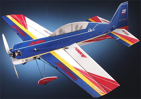

the yak 54 looks killer [link=http://www.horizonhobby.com/Shop/ByCategory/Product/Default.aspx?ProdID=EFL2125]click to view yak54[/link]

The Yak flys real nice. And hovers real good.
