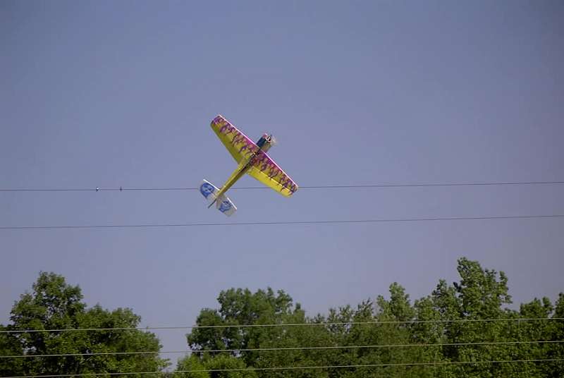

check out the hobby lobby yak55 foamy, it cost $19.90, brushless 400 outrunner $29.95, and it fly's great. go to the yak 55 tread and also hobby lobby web site they have alot of cool stuff

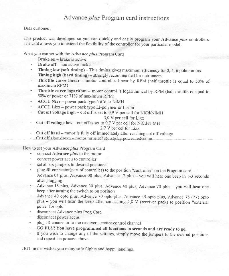

Ok, I got all the foam together. Now what is the prog-card? Is it a one time thing or does it need to be connected all the time? Is the bar pin the setting or the jumper the setting? nuff questions
Old 05-28-2005 | 10:32 AM
Joined: Sep 2004
Posts: 11
From: Tyrone, GA
Default RE: Which foamy should I get?
sorry about he double post. I got all the stuff that hobby-lobby recommended. It is a jeti controller. I have read all the instructions and it says what the settings are but doesn't describe what the setting are for. example: brake on/brake off,timing,throttle curve,cut off type.

AW - I scanned in my instruction sheet for the programming card. It isn't much but does tell you what each setting does.
I'll upload it with this message. I hope this helps.

Thanks, got the controller programmed. I hooked everything up to see get all the horns straight and the prop is spinning the wrong way. I tried to reverse it through the radio but then it just beeps and then goes full throttle until I pull the battery. Any help would be appreciated. All the servos are working fine.
