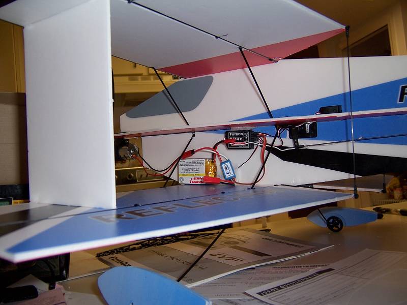

Any pictures from anyone yet ? How about a close up of the top control horns on the ailerons. I want to make sure what I am doing is right. They are sticking out QUITE a ways...so I think I am going to cut them back a bit. Also, do you just not clip the top wing rod into the control horn since there isn't a clip there ?
Thanks !!!
- Jeff
Thanks !!!
- Jeff
#64
Will these help?
Keep in mind that I had to cut away the original aileron links (connecting the upper to the lower) b/c I had too much binding in them. You can see where they were in pics though along with the new ones made from servo horns and micro clevises.

That is EXACTLY what I needed. This model has been a pain and I have made quite a few NEWB mistakes. Although I have had a great time building this one...I really think I am going to go get a second one at the LHS. The Z-Bends BLOW !!! I am going through this whole kit and completing it so I can learn from ALL the mistakes up front and then make the one I will fly.
Thanks so much for the pictures. I almost have this one completed. It's looking pretty beat up...but man has it been fun !! The next one will be soooooooooooo much better =- ).

Well,
I finished the plane I do have another newb type question though. It's VERY nose heavy. But when I check the CG, it's spot on...I am assuming that this is not normal...am I correct in this ? I am going to attach a picture of what my plane (although it does look rough so please excuse my first build) looks like so ya'll can maybe offer any advice. You will note that I have a tool on the back of the tail to keep it on the ground.
- Jeff
Well,
- Jeff

Hey Jeff, I'm sure someone else noticed this or maybe you have already but the landing gear should be on the front cross members not the rear thats why its nose heavy. But i'm sure you have found this out already. We are flying with the battery pack around 1 inch behind the front cross members. Seems to fly great that way. Man I love this plane. Also 3Dnobody thats a great tip on building it true, thanks i'll do it on my next build. Good flying on the video. wait till you fly it inside "great fun". See ya Bill

Thanks for the notes guys. I will fix the landing gear tomorrow. Also thanks for being patient and answering the Newb questions. This has been a challenge for me. The LHS helpped me a ton today also with some CG and servo stuff. I already have the second kit just in case I made some drastic errors in this build and I loose it (which is...well it's probable)
Did you guys glue in your servos or did you tape them in ?
Also, I see that there are numerous times where double sided tape is required. What are ya'll usin ?
Thanks again for all your help. I think if I had to do it again I would have choosen another plane as my first build...but the lessons I am learning with this one should make me a MUCH better builder in the end. Still practicing in the simulator for my maiden...if all goes well I will be able to go out tomorrow. Have the batteries charged up and ready to go.
