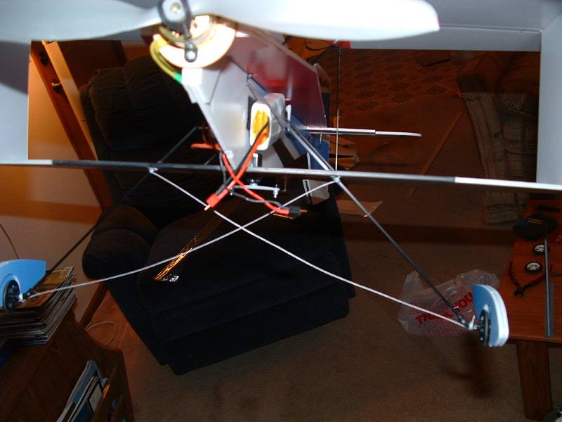

ORIGINAL: WGRoper
First flights were yesterday afternoon, couldn't ask for a calmer day. Man, R/C shouldn't be this much fun! I only wish I had four or five more LiPo packs so I could keep flying.
The biggest problem I've had is where the landing gear pass through the bottom wing doesn't hold up well when landing on grass. After three landings, the holes were worn out and the landing gear was basically floating in the wing. I tried CAing the support blocks to the carbon LE, but it didn't hold. At a buddy's suggestion, I wrapped the support block and LE with thread and soak it with CA. I expect that will take care of it.
Now I just need to fine tune the balance so it'll torque roll properly. Loops and hammerheads are insane with this plane. Mine came out a little on the heavy side at 10.7 oz with the Electrifly 640mah pack. I've got a TP pack that's a little lighter, so it might be around 10.4 or so.
Now I need to get the Turmoil built....
-Greg
Hey there WG...I CAed string from the poit where the LG rod goes thru the wing of one side to the opposite wheel and this really stiffens it up I will see if I can get a pick on here but used to RCG

Old 02-08-2006 | 09:41 PM
  #158
Posts: 101
From: Cartersville, GA
Default RE: Official GP Reflection Build Thread!
That looks like a good idea. The CF rods flex quite a bit on landing, that should work out quite well.
Thanks for the tip!

Old 02-09-2006 | 12:09 AM
  #159
AirNerd's Avatar
Joined: Oct 2005
Posts: 61
From: Mission, KS
Yea mine started to droop and was getting worse so one of the other flyers at my indoor place did this on his.

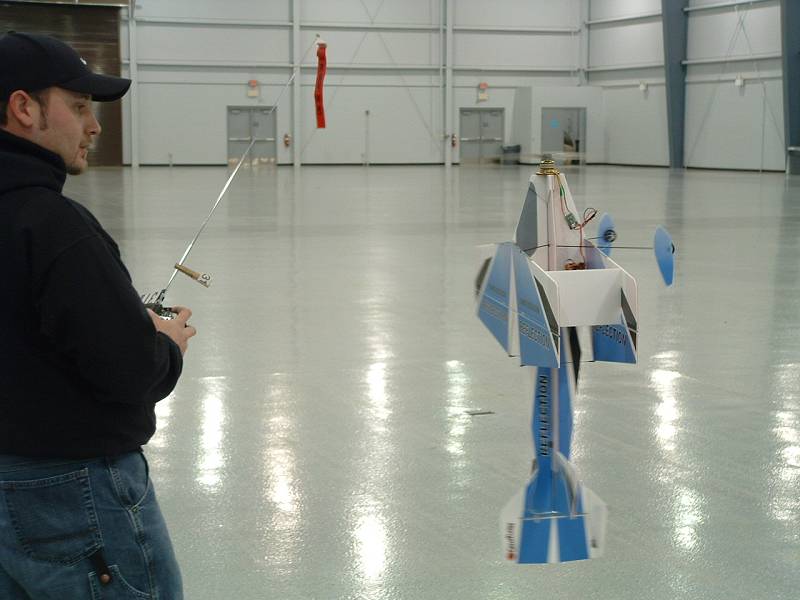

Here is my latest Reflection pic...I can catch it now.

Old 02-24-2006 | 11:28 AM
  #162
Fisher's Avatar
Joined: Sep 2004
Posts: 645
From: Anchorage, AK

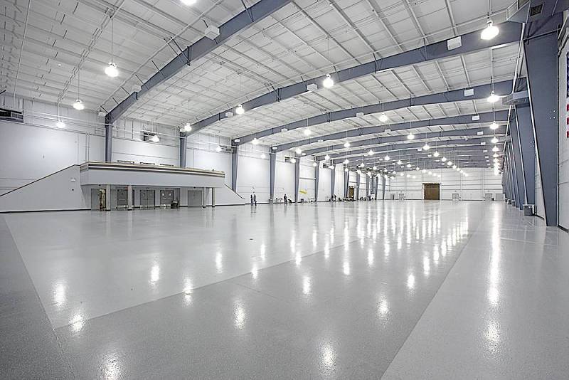

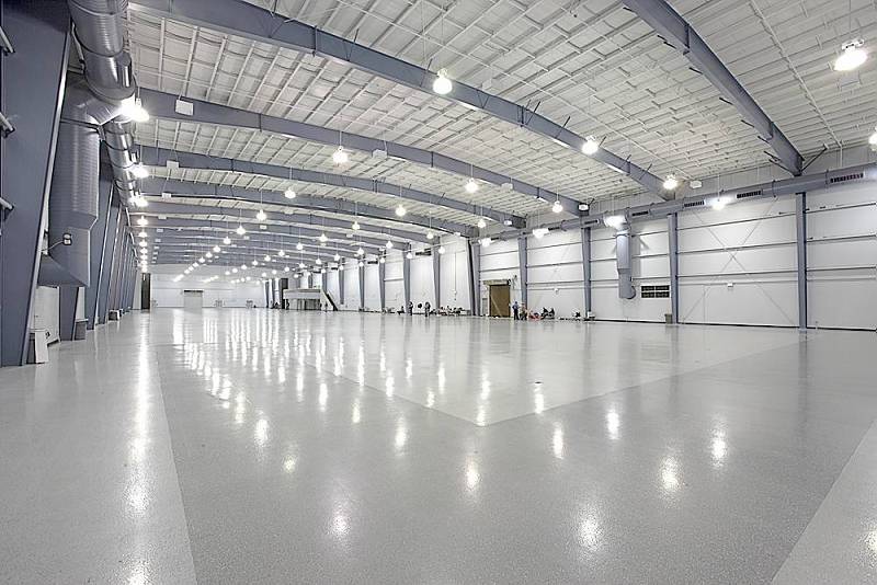

Where on earth are you flying at in that photo? I would kill to have access to a facility like that.
Its called ...the BTC (Buisness and Tecnology College) they have this great big "hall" tha is 450 feet long 125 feet wide adn 40 feet tall, Iit is SOOOO sweet if you are ever in KS look up the Kc flying Circuits.
http://www.kcflyingcircuits.com/
$5 dollar landing fee club member or not!
ORIGINAL: Fisher
