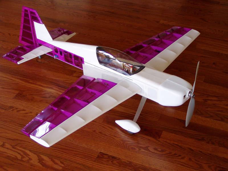

I finished building the E-Tana from Mountain Models. As always Doug was very responsive on any questions I had. Here are the specs:
44 inch wing
418 square inches
28 oz AUW
AXI 2808/24 with TP 3S 2100
I have not flown it yet, I don't yet have the right prop for it, also I like to stare at it for about a week before flying. I think this is going to fly great, the wing loading is only 10 oz / sq ft. and it feels really light. I do have a question, about the wheel pants, they add an once to the plane, and look good, but do they make a difference aerodynamically?

wow, those pants weigh an ounce?! take em off, ull have just that much more thrust out of your power system. they are mainly just for looks, they do very little for the aerodynamics, if anything...

spats DO make difference in aerodynamics. they reduce drag over the wheels, make a larger side area in KE and produce a small amount of lift. i had no spats on my EF yak 54 for ages, put them on and WOW, totally different.....no coupling more rudder power....lots better.
but for 1oz, its quite a lot on a smaller foamy, but on a 28oz machine, keep em on [sm=thumbup.gif]

Just wanted to give a flight report. I have about 8 flights on the etana. Very nice flying airplane. It flies smooth, Beautiful tracking, knife edge, loops, etc. If you are going to put a firewall mounted motor in it, be sure and get the new heavier duty motor mount from Doug. It uses an 1/8 inch firewall.
I would also like to see a little more vertical performance out of it. I can just hover on 7/8th throttle. Not enough for a vertical pull out. I have been doing some experimenting with props, but I think I need to boost the battery. I am going to try an Appogee 2480. Does anyone make a 3000?
The plane floats in for a dead stick landing, it really doesn't feel the weight.
