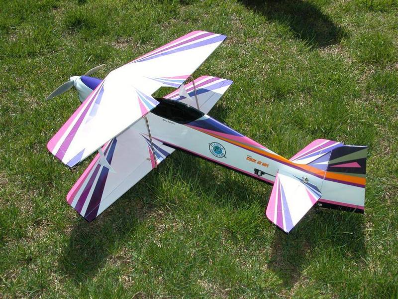

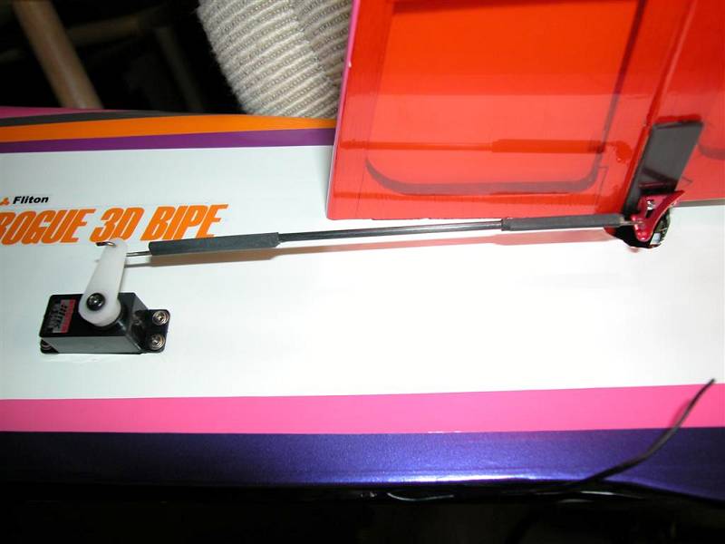

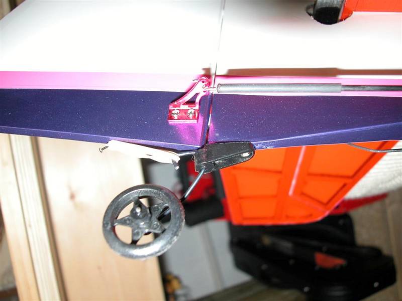

Too bad, I wonder what was so disapointing? If mine flys as good as my ME I will be happy. I stick to the profiles for the slow sick stuff.
Here are some pics of mine. Still no electrics in it.

Here's the parts list I used on mine
E-flite Park 480 910kv
E-flite 11x7 prop
E-flite 40A brushless ESC
4 Futaba 3110 servos
2 15" extension cables for the rudder and elevator servos
2 8" extension cables for the aileron servos
Hitec 05S reciever with crystal
Carbon tube (for reinforcing the elevator and rudder pushrods)
I was using a cellpro 3cell 1250mah 15Cdischarge lipo, and it worked fine. I would however recommend a TP 3cell 2100mah for good long flight times.
All this, you should be able to build one for about $380 or less.
This set-up works great, plenty of power for nice clean verticals.
You will need a dremel tool, assorted screwdrivers, needlenose pliers, CA, epoxy, X-acto, and some drill bits and a drill.
Depending on your equipment, you may need a soldering iron and solder for soldering connectors.
