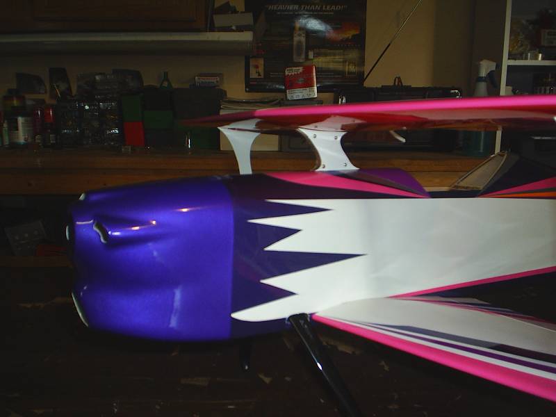

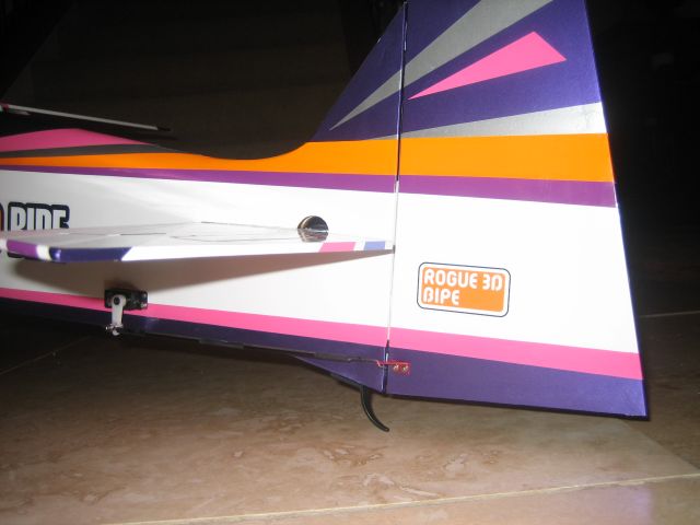

Just finished building mine. I'll post some pictures with some mods I adopted. Setup is:
Hacker A30-16M
X-30 controller
APC 11x5.5E prop
TP 2100 Prolite
HS-56 servos all around
AUW is 29 ounces. If it flies heavy (I've heard it flies great at this weight and with this setup), I'll back-off to a TP1320 prolite pack to move the AUW back to 27 ounces and fly with appropriate throttle management to control the amp draw within the packs limitations and/or prop down to a 10x4.7SW
Hope this helps
Greg
Old 03-07-2006 | 01:48 AM
My Feedback: (39)
Joined: Aug 2005
Posts: 105
Received 7 Likes on 5 Posts
From: Alamo, CA
Default RE: Rogue 3D Bipe
As mentioned, attached are a few pictures of my Rogue 3D illustrating how I painted the canopy to match the design lines of the rest of the aircraft and a few others. I hope to maidening it as soon as the weather permits, but its been awful here in Northern California......
Greg

That's quite a bit heavier than the 24 ounces quoted on the specs. It's only 5 ounces, but thats a lot of weight on a small electric plane. Keep us posted.

Barry..the Mods are did are as follows:
1) stiffen up the langing gear plate by soaking it in thin CA followed up by medium CA where it connects with the fuselage supports.
2) be sure to use epoxy (removing the covering to expose wood) to join the elevators together
3) I painted the aileron connecting rods white
4) masked off and painted a design to match the fuselage on the cowling
5) seal all control hinges with hinge tape
6) built a battery floor with velcro strap to hold the TP2100 prolite packs I use.
good luck!
Greg
