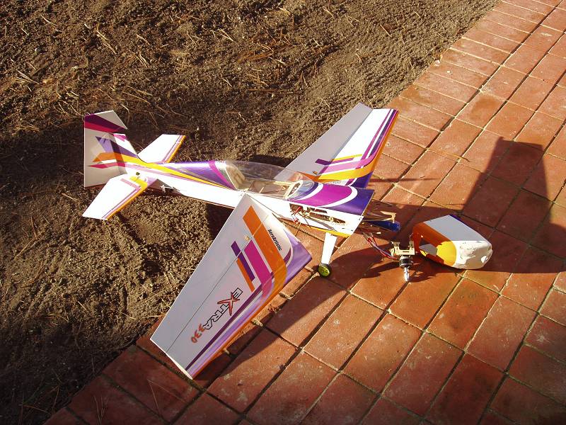

I lost mine today when the spar failed doing a snap roll [:@] I had beefed up the wing joint but I guess I was flying a lilltle too hard oh well . I really wish it had a stronger wing setup. I'm not gonna try to fix it as the spiral down from 50 or so feet broke way too much , and it would weigh quite a bit more after I repaired it .
Now what should I replace it with is the question
I had an eflite 480 1020kv and 40amp esc with 2100 hyperion lipo in it and had insane vertical and was obviously too much for the mini extra . She'd have lasted longer with some throttle control but I was just having so much fun I got way carried away and killed it.
I hate crashing ,but I love getting new planes

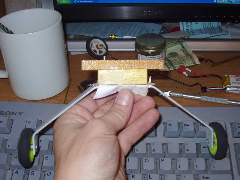

I also fly one and already after the first landing, the landing gear broke out of the fuselage ..... I still have to repair it but have difficulties finding a suitable one.
I saw that you already installed another one. What kind of brand and where did you buy it ? How is it attached to the fuselage, could you show some pictures please ?
Last but not least, would you sell the landing gear ?

here is a pic of the gear it is 2 1/4 inches wide where it mounts to the fuse with a 3 inch rise and is 7 1/2 inches wide at the bottom it still has the mounting block attached with the 440 blind nuts/screws so you can see how I had it in there.If you can get some 1 inch aluminum flat stock you could make it yourself. I plan on reuseing mine on my next small balsa electric plane that I WILL probably rip the gear out of [:@] beside it would cost way more than that gear is worth to send it to you
