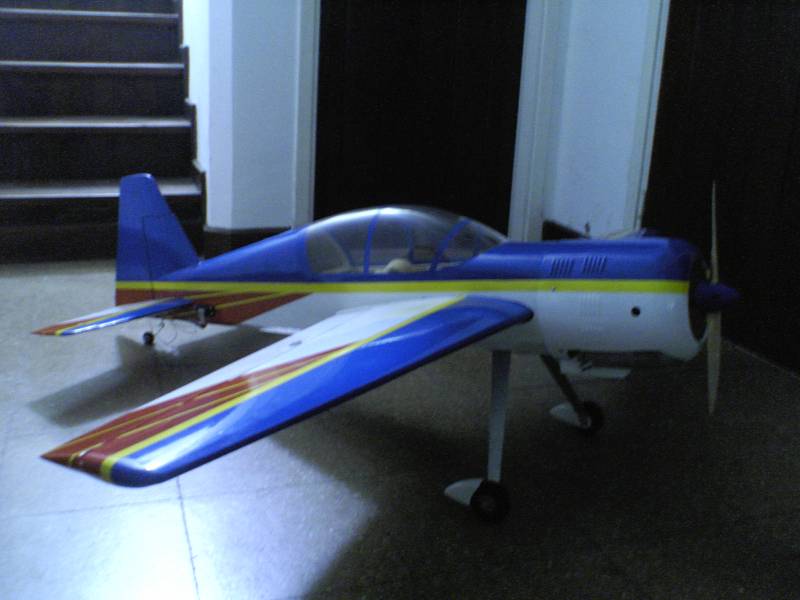

Tarts, sorry for the long delay in answering your question. The answer is YES. The Yak flies great with the OS 46AX but you will have to use an APC 12.25X3.75 and a minimum of 5% nitro. I flew good with 11X6 and 0% nitro but it did not have punch out from hover.
I'm building a second Yak but with the Russian Thunder paint scheme that will be powered by the OS 55AX, slightly more powerful than the 46 and just a tad heavier. It should be all out 3d. Will let you know how it goes. Take care and good luck.
