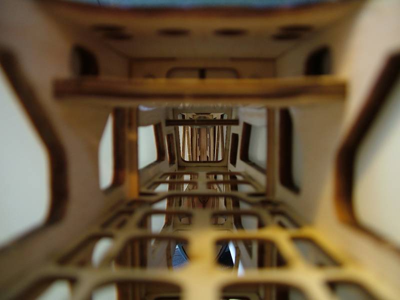

After you get done pulling out all the stuff from the amazingly small box, and marveling at the planes construction. Its time to get started.

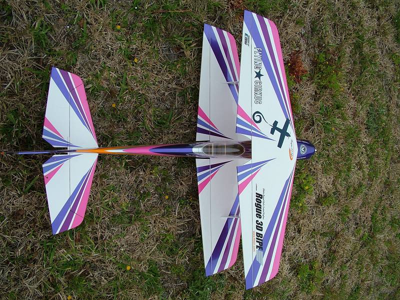

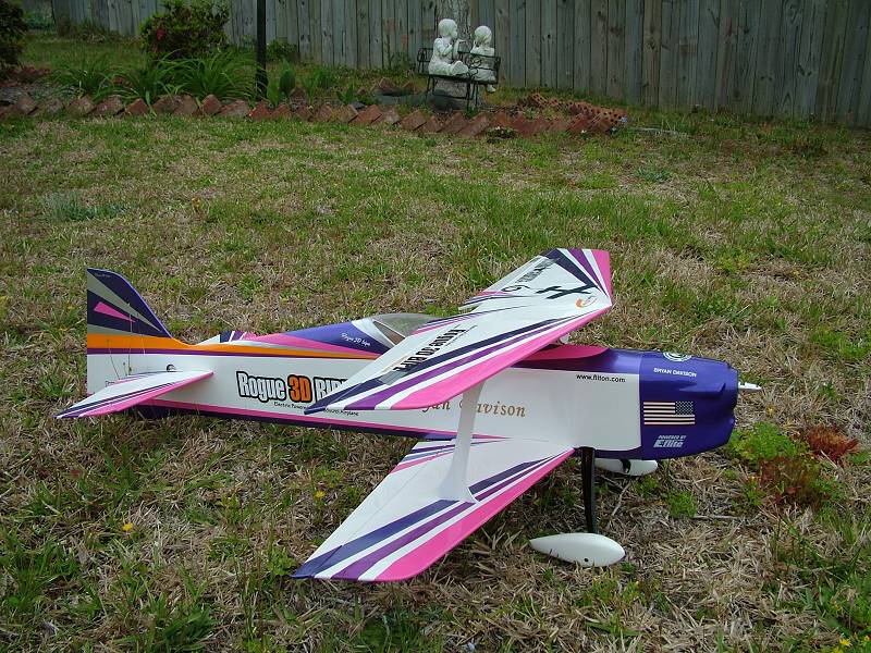

The final steps are simply installing the cabane struts, attaching the wings, installing the radio, ESC, and linkages...all standard stuff for most modelers. The kit includes all linkages, and really cool red anodized aluminum control horns. And of course adding the included graphics to the plane.
I havent put all the servos or radio equipment in yet, because I havent decided quite how I want to do it. I was thinking of modifying the kit for a push/pull rudder, and perhaps dual elevator servos. But you can see what the completed plane looks like.
