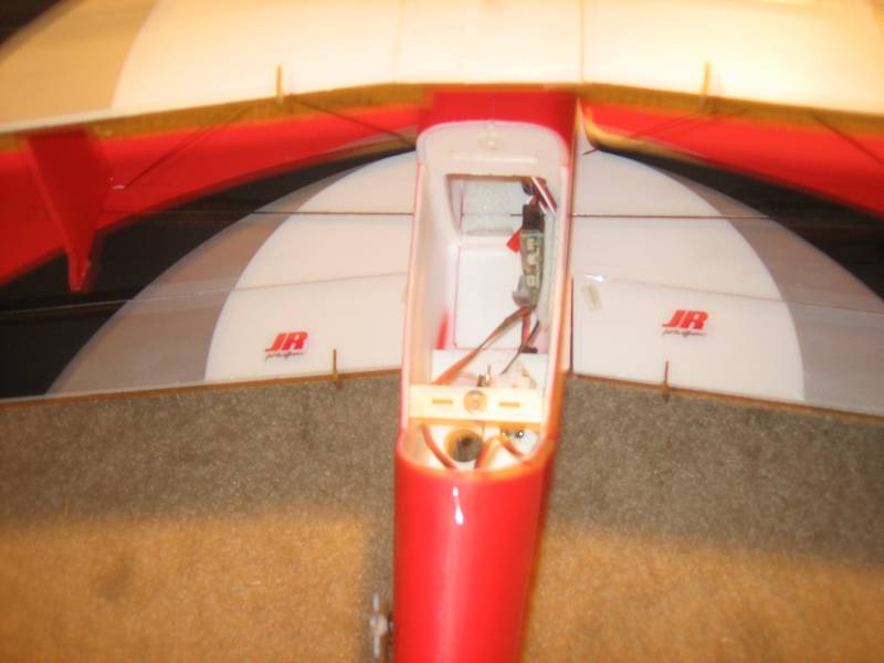

i just finished my ultimate fx today. i did my maiden flight which was pretty good. i still need to make the pushrods from the lower ailerons to upper ailerons. i am running an e-flite s75 for ailerons, jr281 for the rudder and elevator. i have a 35a esc but with an e-flite 370 motor so i can't go full throttle or i will ruin my motor. my ulitmate fx is not super stable when i take off and land. every time i try to fly it upside down the plane flips me back over. and everytime i go into a hover it throws me upside down but then flips me back to normal. the last problem with it is that when i try to go downward it whips down to a 90 degree angle every time no matter how much down elevator. my motor mount stick was offset by a lot did this happen to anyone else? i will post images in a little bit

One of my students recently build a Ultimate FX, and wanted me to take it up for the maiden. Ive seen these planes before, and never gave much though to them. Mainly because I know what other ultimate biplanes fly like. Well, anyway....I took it up.
Instant love affair. I gotta get one of these for myself. Its a superb flying plane.
Id also agree...its sounds as though the CG is off. Which is understandable with the location they provided for the battery. It does fly better in my opinion a little nose heavy, but it sounds like yours is WAY nose heavy.
If its nose heavy, on your landing approaches, keep a little power on it. Like about 1/8th throttle, and bleed off airspeed. It should be cruising very slowly, let it settle, and flare for the landing. It takes a little practice with it.
DONT dive it for the runway. Make a long smooth level approach.
I had to go over this with my student too. He also was having issues with it nosing over on the landing. A little instruction, and now he can set it down really smooth.
Also, I noted that you said you maidened it, but still havent attached the ailerons??? ALL FOUR ailerons must be working correctly. Post some pics, that should help us determine what is wrong. The plane should not roll on its own...when its setup correctly, it flys very VERY well inverted. On my students one, its completely neutral inverted.

when my mom gets home in like an hour i will get the pictures up. so i should put a little weight on the tail end. i hooked up the four ailerons now. i am using a 11.1v 1200mah but it only gets about 5 minutes on it which stinks. my elevator is about 2-7 degrees off. would that effect it. when i post my pictures look at the elevator and rudder are slightly angled. did anybody elses stick mount appear to be a little bit leaning to the right when looking at it from above.

in one of the pictures you have to look closely but you can see that the stick mount is slightly angled, the elevator and the rudder are all slightly angled. i fixed the elevator a little bit today with a carbon rod

Well....thar's your problem
1st....connect the ailerons thats a big one, and would also explain your 90 degree action when elevator is applied....the unconnected top ailerons are going to work like flaperons or spoilerons depending on airflow. You cant have loose surfaces like that.
2nd. the tail canted like that wont work. It needs to be dead level.
Remove the bottom wing from the fuselage only. Then line everything back up square, and re-glue it. You dont have to undo the cabane struts, the top wing should follow the bottom wing once its all squared up.
What's happening is everytime you pull up elevator, the plane will roll because the wings arent square with the stabs. Im surprised it flew at all without the ailerons hooked up.
Follow the instructions carefully.
The stick mount looks ok. It has alot of thrust angle built in from the factory...

my tail i fixed quite a bit the elevator is now about half as angled as it was in that picture. my rudder came angled like that when i bought it at my LHS. the wings are level and were pretty level when this picture was taken i added a little weight to the tail so should this help the flying because i haven't flown it today because of 30 mph winds

i tried another flight this morning absolutely no wind. i go to takeoff and it is all over the place i have to make an emergency landing after about a minute in the air. i will post some more pictures because i am so frustrated. my ailerons are connected my elevator is barely angled and now i put a small dent in the cowl bcause of the emergency landing. everytime i take off the nose go straight up but then i leveled it back out again tried to turn just sat there kept going straight then finally turned. i have like barely any control over it and i need helppppppppppppppp. i will video tape my next flight after i try and fix what ever you guys tell me. i will also post some pics in a couple of hours.

Where is your CG?
It should be around 4" back from the leading edge of the top wing near the fuselage.
If its not, you will need to reposition the battery to get it as close to that as possible.

Sounds exactly as bdavison is suggesting. Your cg sounds way off. I'm looking to get one of these little planes as they look like blast to fly... and at 60 bucks for the plane and the 400 eflite outrunner you can't really beat it

That's your answer then. Try moving the weight forward.
As per the manufacturers specs:
CG (center of gravity): 3-1/2 in (90mm) to 4 in (100mm) behind the leading edge of upper wing

thanks guys so much i went out this morning and flew. it was pretty windy but i did flips nicely. i only get about 5 minutes off an 11.1v 1200mah which i don't like. i am going to try my 7.4v 1600mah also.
