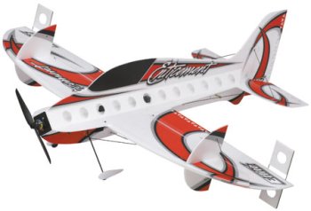

Anyone flying this plane yet ? Saw one at lhs yesterday and was looking at for indoor flying this winter.

Just got mine built, weighing in at 4.7oz, setup: e-flite 250, 3 jason schulman servos, castle speed control, 340mah 2 cell bad dogz, and berg rx with the lightened antenna from e-cubed rc. There are no connectors on this plane for the electronics, i have soldered everything direct. The cases are off the rx, and speed control, to save weight and cut down on the precise soldering, I made a common power and ground. so there is only one "full" set of signal, power, ground going to the rx on ch3(speed control) all others just have the signal wire running to the rx. I also cut out some of the carbon fiber from the tail section, and used fishing line to create "flying wires". It seems light enough to be really nice to fly, i cant wait.

The plane flew very well, i flew it both with the sfg's and brakes and without them , needless to say i like it better without all that stuff on, it rolls better, and i auctually like knife better.

Hi, I'm considering the Enticement..have the Extra 260 right now at 6.5 oz...how much better (slower) would the Enticement fly at 5 oz.? I like your ideas of minimizing cases, covers, plugs etc.

I had the extra 260 as well, it is definately a great flying airplane, but having one that weighs in an ounce and a half less does make a difference. This plane crawls. I took off the sfg's and airbrakes because it seemed to slow some manuvers down and it wouldnt roll as fast as it did with out them. For me ill take the little extra speed for the better roll rate. Others may want to keep them on. If you can keep the 260 and build the enticement, they would both be great in the hanger, but if you have to choose id choose the enticement. As long as your flying indoors you'll love it. The 260 i remember id fly outside sometimes as well, ill leave the enticement indoors. As far as cutting the connectors and soldering everything direct it may not be needed but i just like to shed any weight i can off the plane.

I think I'm at the min weight for the 260, set up: two s75 servos only..no rudder..single for ailerons..surprisingly good without a rudder. No wheels, or L/G, or carbon struts..spectra line everywhere. Carbon mount for the Eflite 250 outrunner. Spektrum DX6 rx, 900 mah 2s lipo..flys forever.
I bought the 260 because the FSOne sim now has it, and editing for less weight and power is very interesting and realistic. I tried it at 5.5 oz, very nice. The sim and real life at 6.5 oz are very very close.

Just flew mine last nite and it flew awesome.Nice and slow and real strait and smooth.Would recomend to anyone flying indoors.My setup was as follows.If your into 3d I would not recomend it.
e-flite 250
thunderbird 9
s60 servos with the cases off
thunder power 2s 480mah

I got mine built today and went to test fly it. I hate to say it but after the first(and last) flight I still don't know how it flys. I took off and had it up trying to trim it out and what ya know before making a turn the wing broke.[:'(] I think they have a problem with this setup as there is very little bracing for the wing. ANY ONE have any input????????????????????

Sounds like maybe one of the CF rods popped out causing the wing to flex and then eventually break.

Sound like it wasnt constructed correctly. I hardly ever fly mine outside but i have and i have had some pretty fast down lines and pulled hard no wing breakage. I hate to ever use epoxy on anything on the electrics, but i did opt to use a tiny little bit on the carbonfiber wingstruts where they come together in the middle of each wing half. as far as extra tape and carbonfiber on this one, i dont think they went crazy with it like they did the extra 260. i did leave out some carbonfiber and replaced it with flying wires but thats it.

i got mine set up 4.5 with 2 dymonds and 1 s60 with all covers taken off the recievers and speed contralers and batteries and i also set up pull pull with 6 lb fishing line i was using a 250 with a thunderbird 6 speed controller. i also did not put on the drag devices but with drag device it was still under 5 but i was also using flight power 350 2 cell to make it light. So ready To fly the plane weighed 4.5 without drag devices
