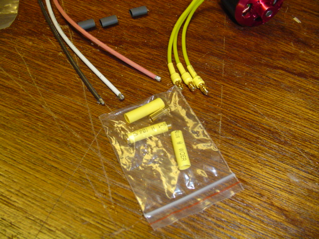

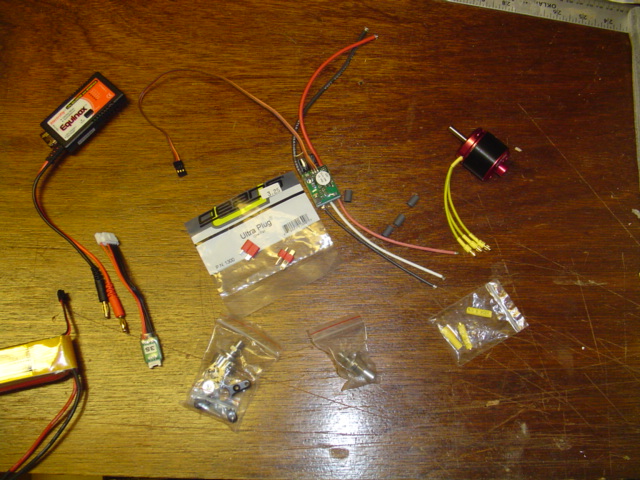

I have been flying 20 years but this is my first electric. I put a few pics on for refference.
The motor to speed control? I get it that the three yellow wires from the motor go to the three from the ESC. But in what order? Does it make a difference?

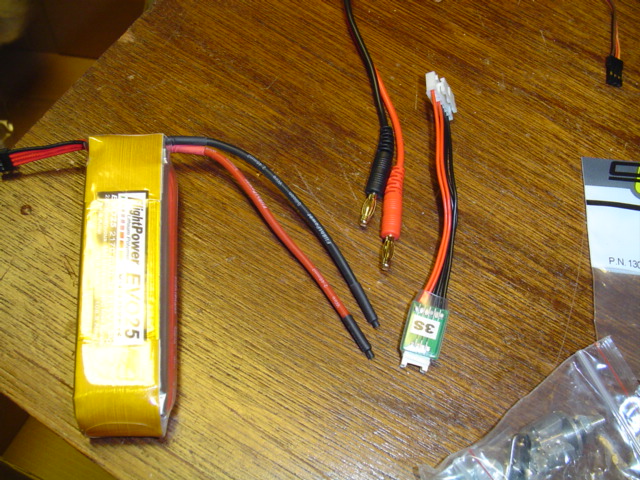

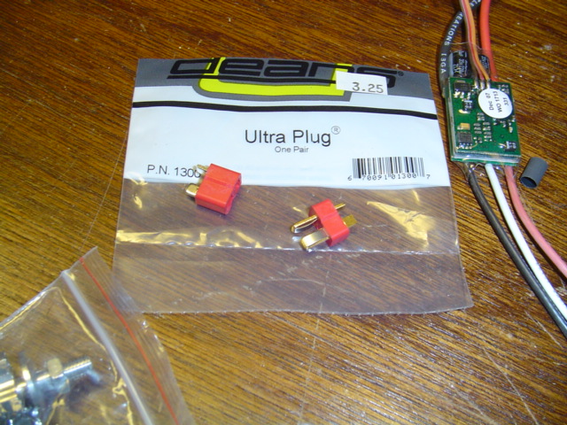

Deans conector to battery pack? There does not seem to be a lot to solder to. Any hints on this? Also should I put the female on the pack or the ESC?
I think I understand the balancer. I read the book and will re-read it a few more times. Same on the ESC. It has a pretty detailed book. The motor had nothing with it. They assume you know what your doing already.
Any help is great. Please feel free to give me any details you think I may need. The LHS put all this together for me. They are a big help but it's 100 miles each way to get there. BTW this is an Extreme Flight 48" Yak. I bought everything but the RX. I hope I have everything I need.

The three wires between the motor and ESC don't make much difference. Wire them together temporarily to verify proper rotation direction. If rotation is the wrong way, just switch any two leads to reverse it. You want counter-clockwise rotation looking at the front of the prop, just like nitro/gas planes.
You never want exposed connector pins on the battery pack, especially if it's a LiPo pack! This means you should use the female Deans connector on the battery, and the male connector on the ESC.

Red and black goes to the charger from the equinox. The adapter goes into the equinox and to the balance lead of the battery. The HD wires from the Bat. go to the esc. using deans plugs. The motor is three phase so it works either direction. The esc's red, white, black, go to the motor. The servo lead goes into your Rx's throttle channel. See proper servo travel direction notes below. What I don't see is a prop hub. Most motors have a hub for each end. and you choose which way to point it depending on how it mounts in the plane. Then plug the wires in till you get proper rotation. Before putting a prop on it confirm the motor and throttle servo direction work correctly. Reverse the servo/esc. if needed. Or you will have an unguided missle raising havoc in your shop. Did that once, prop on, it went straight into the trash can and commenced to empty it. Was a hoot after I got the bleeding stopped on my knuckles.

On those Deans, I guess by now you found the tiny little "+" and "-" on them?
If you buy a pack with a Deans connector already on it, you'll obviously want to be sure things line up before connecting it.

Check your Deans again... the + should be at the wider/sideways end of the connector. Its also the one I solder first, then I turn the plug sideways and do the neg side... it is a bit helpful to notice that the solder posts are both off-set a little to the sides - put the wires on the side(s) with the most room.
If yours are backwards, practice up with the soldering... swap the wires around. (Just heat, pull apart, clean and rework)
Also.... DO NOT simply take cutters and snip off any connector from any lipo pack all at once... the cutters will short the pack. Cut them one at a time. Same goes for the balance connectors.
