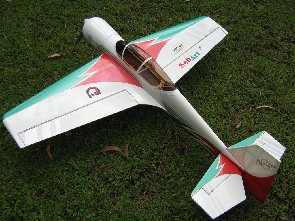

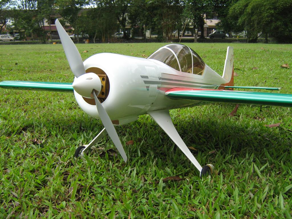

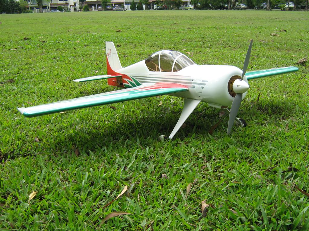

Here is my new toy, Sebart's SU29-30. She is a lovely plane and the build was pretty straight forward. If you are using HS65s you will need to enlarge the servo wells a bit.
My set up is as follows:
Motor: DualSky 3548-5
Speed Control: Turnigy 60A
Battery: Flight Power 25C 4S 2500 mAh
Prop: APC13x6.5e
Servos: HS65
At the moment she is pulling 59A @ 825W. Hope to be able to maiden her soon.
