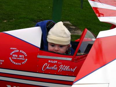

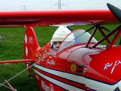

priceless. Dont forget to hang a large diameter low pitch prop to get enough thrust to lift that cargo off.
Or maybe a couple JATO rockets.
