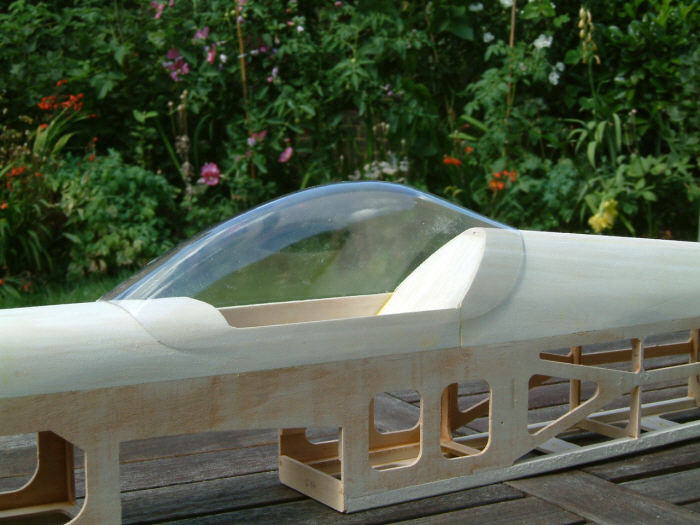

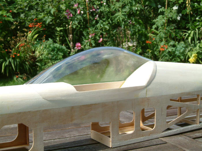

After 4 days my capiche fuselage and tail is built.
One thing i would like to ask fellow capice 50 owners is canopy position. I have noticed that it is possible to move the canopy further forward towards the centre of gravity(by about 2 cms), which might improve knife edge performance. I suppose i can easily find this out by experimenting when i fly it, but does anyone have any comments?
I will post pics when i have the time.
Luke

My fuz is now built (just the sheeting to be done) but I didn't notice the canopy could be moved. I would say (just from thinking about where the lift is acting from) that forward would be best to get the nose higher in knife edge.

put your pilot in the office and where his head is, is where the top of the bubble should be!!
knife edge flight is so good with this plane i dont think 2 cm is going to make a noticable diference.

These are the pics i was talking about. It probably wont make much difference as Dave says.
here is the canopy position that is shown on the plan:

and heres the one where you can move it forward a bit:

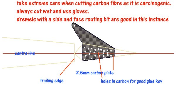

Aileron horns
Has anyone managed to find a suitable horn for the ailerons which will put the clevis pin near to, or on the hinge line, or is it a case of making your own if you want to do the job properly?
I have tried everthing at my local shop and nothing has enough forward cant.
This may have been covered in a previous thread, but I gave up reading it has it was nothing to do with the Capiche!
Rodders

I used these (2 for £1.79)

those horns that Graham has i've got on elevator and rudder, work great, ailerons are still the Pete Tindal horns, nice horns but no good on the Capcihe.

i intend to make mine from 2.5mm carbon plate

yeah mines 3.75lbs (a couple of ounces more now with some weight I put it the back to move the C of G), with an irvine 53 running an apc 12.25 x 3.75, and it accelerates out of a hover like a exorcet ! Forget a tuned pipe it really doesnt need it Luke, maybe a Weston throttle pipe would be good. Knife edge performance is such that canopy position isnt going to make any perceptable difference. Mine will KE loop at 2/3 power no problems.

I meant to add that I ended up making my own aileron horns from alumium sheet as I couldnt find any commercial ones that would get the clevis over the hinge line.

Malcolms CF rudder horn was perfect.
