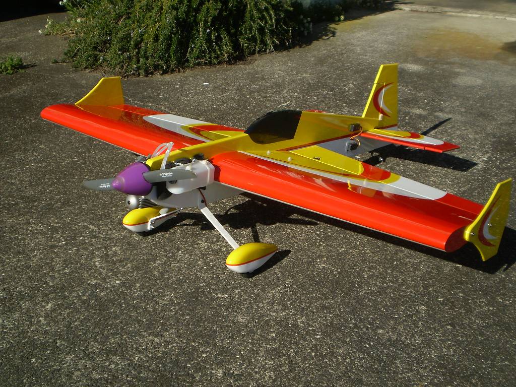

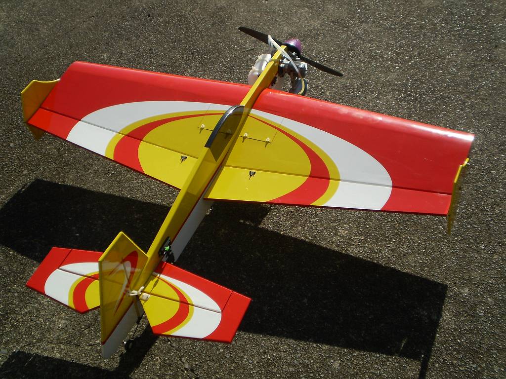

picked up my 46-60 yesterday (sunday).Got the last red/yellow one. seems to be the most popular. Once home opened it up and ogled at it for a while. everything was good.Got the iron and heat gun out and went over everything. Glued ailerons in and then got the dremmel and shaved the fuse to make the Ax65 fit. Will fuel proof once i get the engine mounting drilled.

almost finished.Radio gear to sort, throttle linkage to add and balance and set up the throws and done.maybe add all the decals.

#99
My Feedback: (7)
Join Date: Aug 2004
Location: La Porte,
IN
Posts: 2,505
RE: Goose's Aeroworks ProX260 build thread
Brettis,
Good job!
But it do look a bit naked without the decals.
Where you putting the On/Off switch for your rcv?
One thing AW did on the larger .90 size (prototype), was to put the switch(es) into the access panel covers on the wings.
Not that they'd ever blow off, but doing so would limit that ever happening. I wish I'd done so.
Good job!
