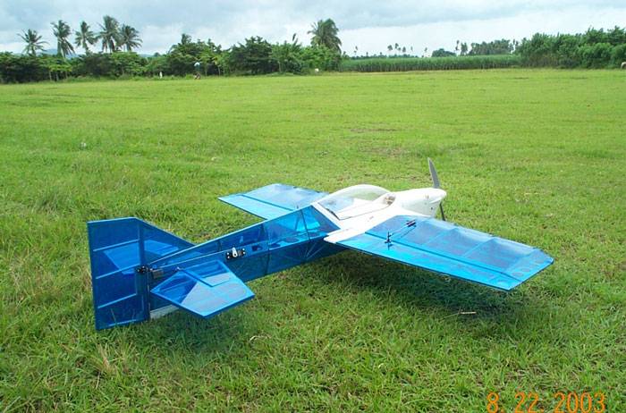

Hi! I'm from the Philippines.
Currently we have the first two Wild Styles here in Manila. A local hobby shop imported them directly from Japan.
It was a blast to build (perfect design/engineering) in 2 weeks time. Covered using Solarfilm (2 rolls transparent blue and 1 roll white).
Here's my Seduction Wild Style using an O.S .46FX for now (saving up for a YS63 ), used JR NES537BBs for elevator and rudder, Futaba S-3001s for each aileron, and Hitec HS-81 for throttle.
