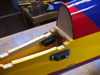

How is everyone mounting there elevator servos inside like
the instruction say with only one servo or in the rear with two servos outside. I am using a Saito 180 I know it would be better to have two in the rear but will that be to much weight in the
back.
also does anybody have any pics. of where they mounted them
in the rear and a little info on how they did the brackets to
screw the servos to.
hanger 9edge 540
Thanks George

I am still building mine & installed two servos in the rear just behind the last bulkhead. I glued in some 1/8 plywood that stretches from the top stringer to the bottom. I cut holes & installed servo's right below top stringer so it would not interfere with the pull pull cables for the rudder. In saying this I am sure I will need the weight in the rear as I am using a fox 3.2 in the nose. Hope this helps.

Is it absolutly necessay to mount them in the rear. I mounted 2 Hitec 615mg's on the servo rail with dave brown carbon pushrods and 4-40 wire. I too have a saito 180 with the battery in the fuel tank compartment and it balances just a little tail heavy. I havent had a lick of trouble.

i ran mine in the rear back in the day i no longer have the bird. i ran 2 jr 8101 (90oz),

these pic were taken off of the below site:
http://www.concentric.net/~Dhmodels/workshop6.htm

Thanks alot for the pics. and link to web site krayzc they help more than anything I am new at building and I get more out
of pictures than people telling me how it should be done.
