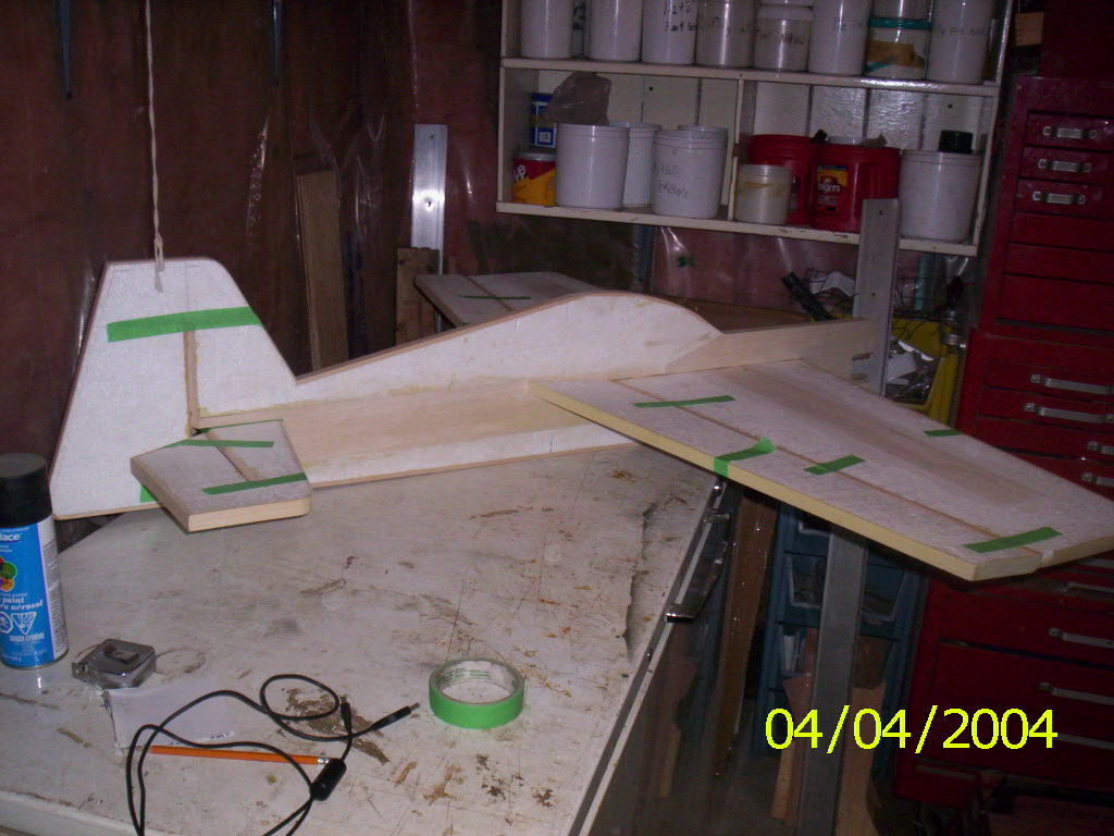

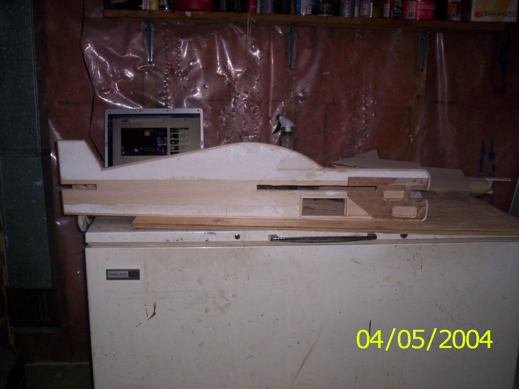

hey every one
iv been out of the hobbie for about 3 years now due to the town i live in theres no real place to fly any more due to community ars holes
any way i cant be bothered with electrics planes im a glow guy i also only scratch build all my stuff.
in the last week iv been getting interest in the hobbie again by consitering to build a cheap RC boat to just going full and building a new plane.
i got an idea of building a true 40 size not an arf that a 40 size that needs a 91 lol and am thinking about a totally flat like a foamy yak
i started oneabout 4 years ago but don't like the foam i was using 3/4inch white flaky junk so im thinking about going with pink or blue hi dence foam you buy from rona or home depo hot wire down to 3/4 inch since i cant seem to buy it 3/4 inch hear.im thinking id use balsa on the edges then ply wood mounts...ect then cover it to make it last.
does anyone know if theres kits or arfs out there like this would any one be intrested in seeing one on the market ???
what do you all think.
sorry for any bad spelling

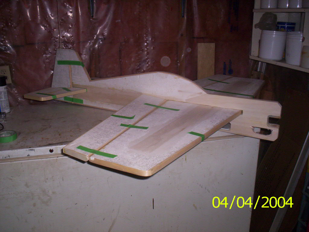

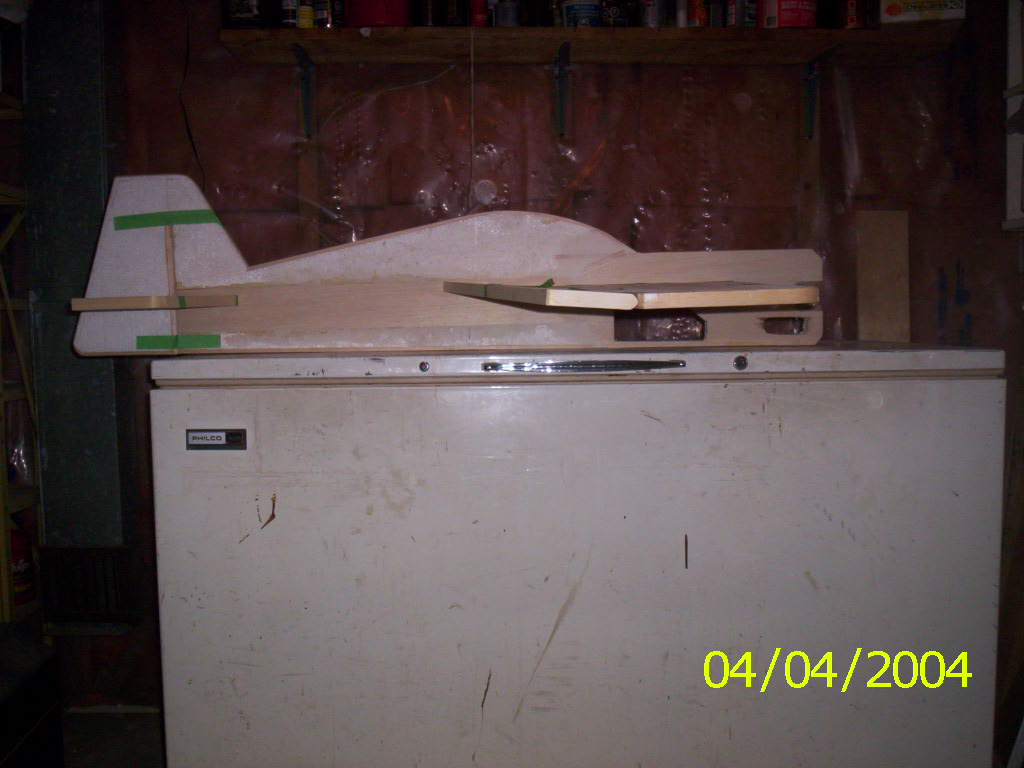

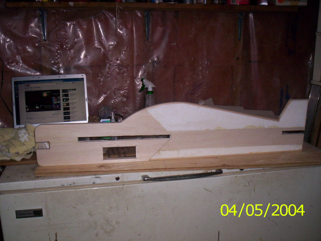

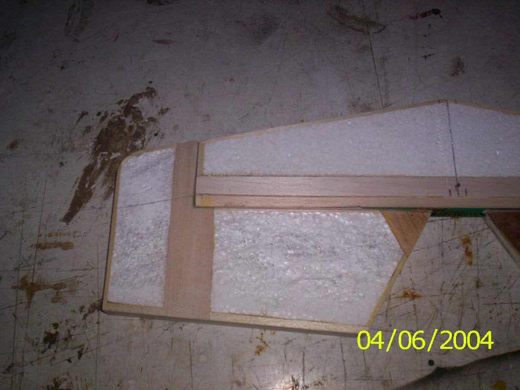

my first attemp but not happy with it gonna start over its 56 inch wing span

after thinking about it for a wile i think i figerd out how to make this work ill post pics as i go to bad theres no kits like this bet its gonna fly awsome

Isuppose the 'not happy with it' part just doesnt show in the pics above, cause that thing looks great
Im sure you already know, but that pink or blue foam is much heavier than the white stuff. The white foam sheets Iget at Home deport is rated at 0.7 - 2.0 lb per sq foot, where the blue/pink are more around 3-7 lb per sq. foot ranges .. (guessing) .. Being you are using balsa/foam combo to build, Idont understand why you wouldnt want to use the lightest foam avaliable. Not to mention the white stuff is cheaper, if Iremember right. Iunderstand the higher dencity stuff is smoother material as far as cutting and sanding smooth, but if your using balsa's as well, some light filler takes care of any imperfections prior to your balsa caps or sheeting. Even using the standard amber colored gorilla glue works wonderfull on the foam, due to its foaming up as it cures, it will fill in any little foam chunks that may have broke loose from sanding or carving..
Just some penny's to throw around, is all.

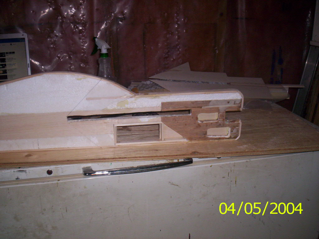

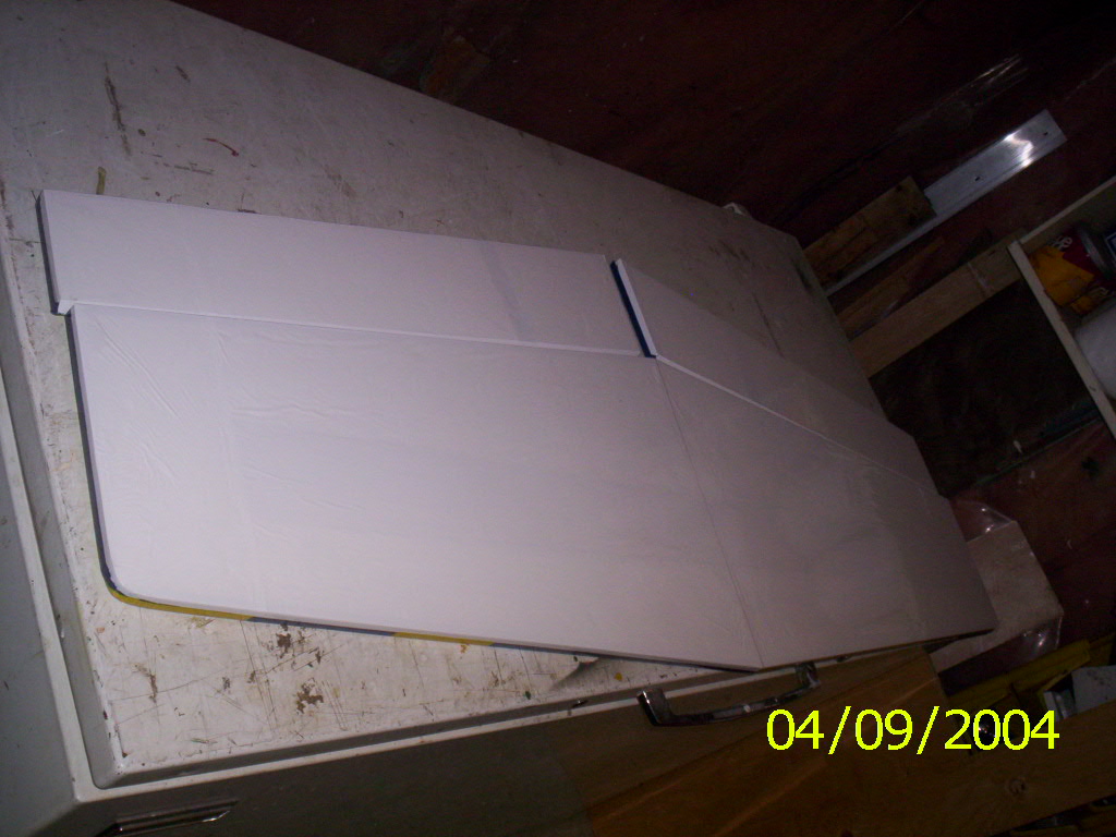

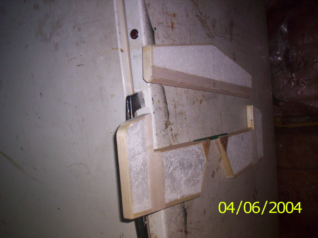

i think i fixed my littel issues im picky when i build

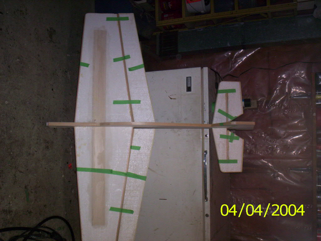

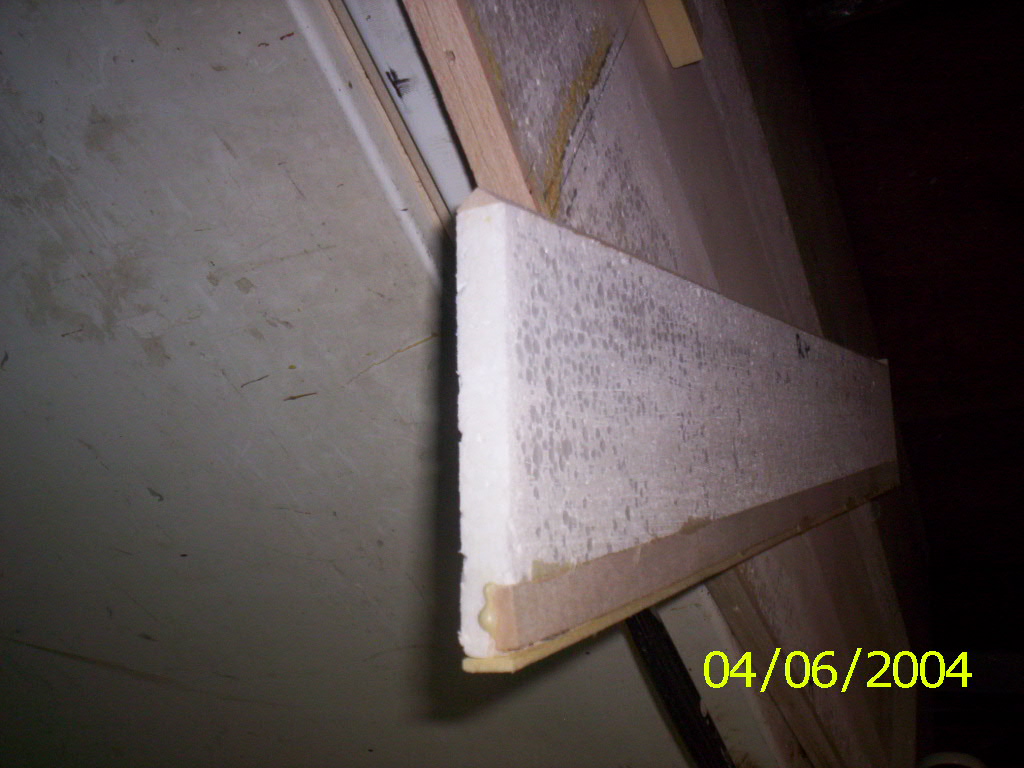

well after sanding it all down and adding a few extra balsa strips im very happy with how this projet it looking i was worried that all flaws would show throw the covering but not one flew shows now hears some more pics

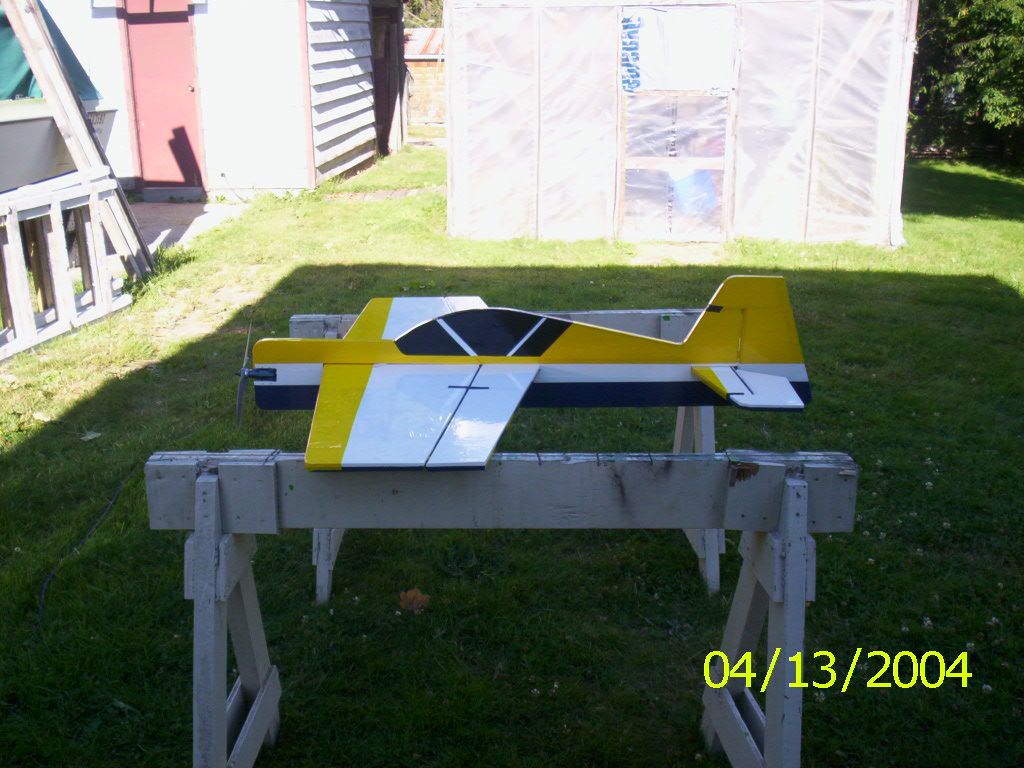

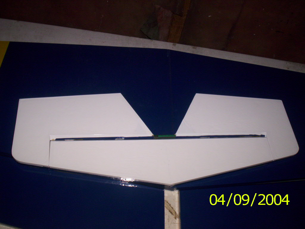

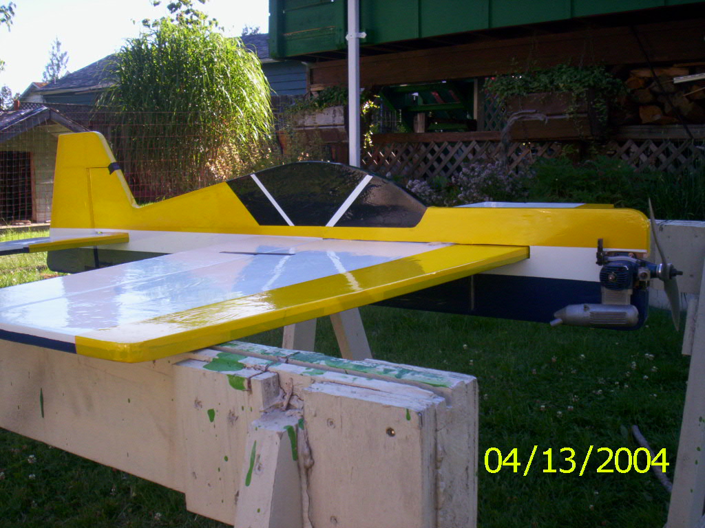

its 56.1/4 inch wing span 910 inch square i est with the la 46 i got its will be 3 to 3.5 lbs ready to fly this plane i drew up as a 90 size profile but never got to building it so i came up with the idea of this 4 years ago and have been in and out of the hobbie but happy its finaly comeing together i sure wish some one would
make a kit like this i might just start makeing and selling these i priced it out ready to cover would be about $65

Looks fun, though I don't know much about foam models. If it was me I'd have rounded the leading edges and tapered the trailing ones. I see alot of drag adding up there.
Old 07-30-2012 | 04:15 AM
Woody218's Avatar
My Feedback: (24)
Posts: 751
From: Bismarck, ND
Default RE: 40 size flat out what do you think
ORIGINAL: Charlie P.
Looks fun, though I don't know much about foam models. If it was me I'd have rounded the leading edges and tapered the trailing ones. I see a lot of drag adding up there.
This is a 3D aircraft, moving very slow most of the time. Drag is a non-issue at the speeds this plane will be flying.

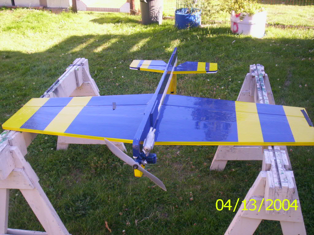

shes one of a kind the front wing ill be wraping it with the tape with fiberglass string im not the best at covering
