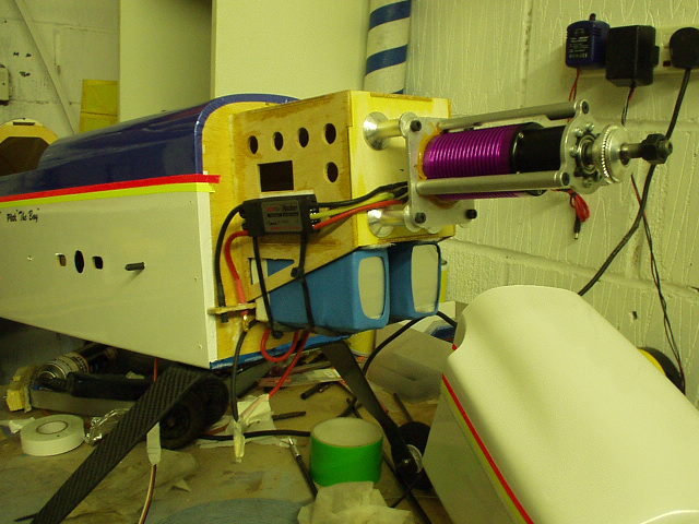

A little more info on the Electric 140ex.. It has been set up to run on
80 Kokham 340 SHD cells wired in 8 series - 10 parallel, to produce
32 volts, with a max discharge current of 100amps, although current
set up is drawing 58amps at full power, which is 1400watts. It is
likely that an additional 20 cells will be required for optimum
performance, but with a 22x12 turning at 4600 rpm which should
generate approx 13.5lbs thrust, it is hoped that this should be
sufficient for initial test flights and the forthcoming competition this
weekend.

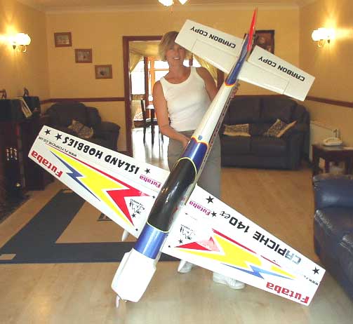

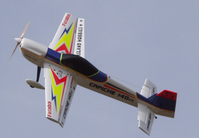

Meantime here are a couple of shots of both the IC and E……
C140ex’s…
Pictures will appear in a later post

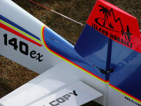

Plug in tail...
Does that mean just the stab or the whole tail section?

just ran the motor in the garden, it will pull out of my hands all the
way through the battery cycle, not loads of extra power yet bet its a
start.
