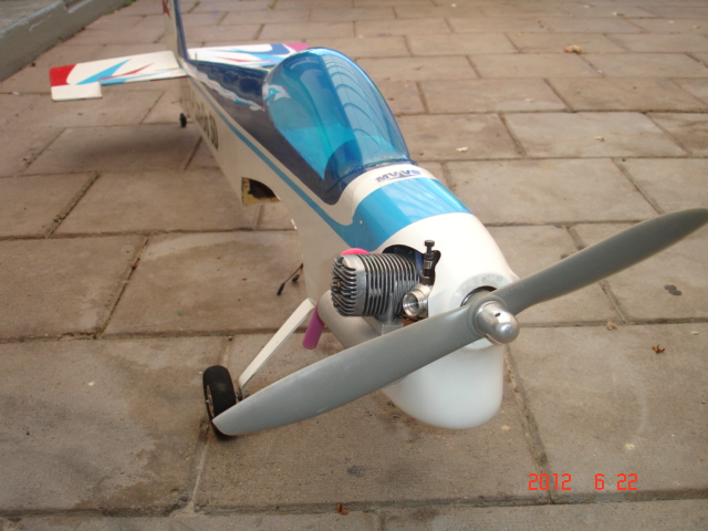

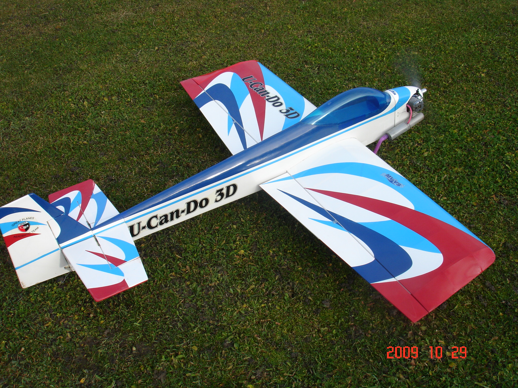

Old 11-04-2015 | 07:44 AM
Posts: 7,816
Received 10 Likes on 10 Posts
From: Upplands Vasby, SWEDEN
Hi!
In my You-Can-Do .60 powered by a MVVS .91 two stroke the best prop so far is a 16x4W APC.
So I guess a 1.00 four-stroke in the same plane can swing a 17x4W or there about.
A 15x4 will be way way to small prop for that engine!

Old 11-04-2015 | 08:44 AM
daveopam's Avatar
Posts: 7,810
Received 43 Likes on 38 Posts
From: ELK CITY, OK
The MVVS 91 two stroke is much more powerful than the Saito 1.00 four stroke. A Saito 1.25 is still not enough to turn a 17x4W. Not trying to be a know it all, but many people read these post. I don't want to see them make a mistake.
David
