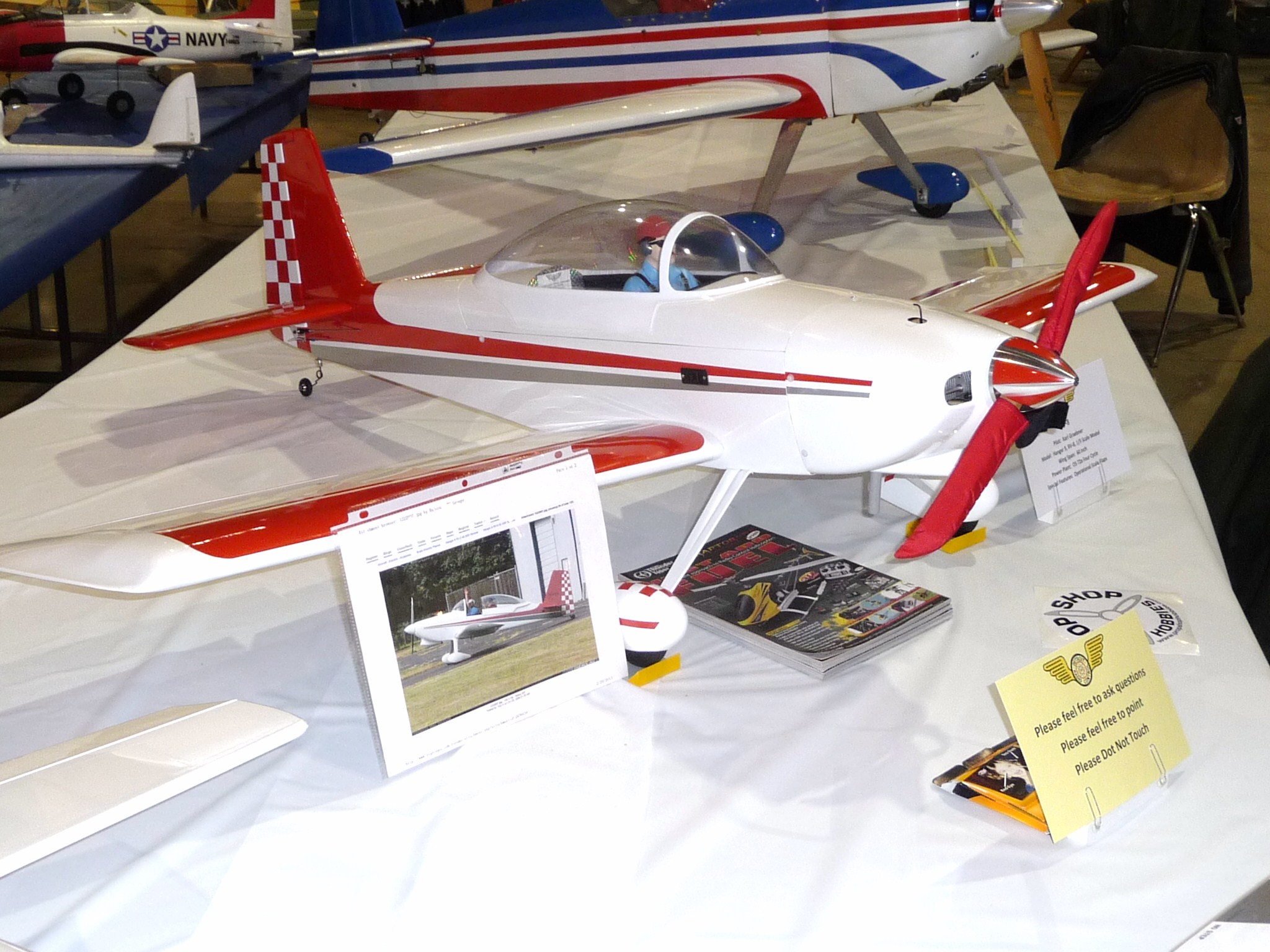

Just make sure on these NIB katanas that the shear webs are in the correct direction in the wings.. I watched 2 at my field have the wings go boom.. and that was with very conservative pilots flying them. Horizon replaced both and one of the replacements is still flying..
Old 11-15-2016 | 10:39 PM
  #37
extra300crazy's Avatar
Joined: Apr 2015
Posts: 164
From: Clinton Twp. MI.
2walla,
Normally the shear web orientation is vertical. Do you mean that some shear webs were put in with the balsa grain runnung horizontal? I have a Hanger 9 RV-8 that has most of the shear webs in the wing where the ends of the shear webs don't completely go to the sides of the ribs. I fly that one competely in a scale like fashion. I would expect better from Hanger 9, especially since the Katana was designed by Mike McConnell, Hanger 9"s pro designer. I'm starting to understand why the Katana was discontinued.
Karl
Old 11-17-2016 | 08:11 PM
  #38
My Feedback: (10)
Joined: Mar 2003
Posts: 733
From: walla walla, WA
Yep shear web was put in the wrong way on many of them.... not Mikes fault-- poor QC... I have an RV... I need to fix it as it was in a midair and lost half the stab and took a big chunk of wing out.... I should fix it someday...

From everything I've read on the Katana, there were problems with some of the first sold, maybe the first few hundred? Hard to say, I'm not even sure what to look for on the wings to know if I'll have a problem or not.

Let me know if you need the SFG's. A way to check on the shear webs is to inspect the spar area through the wing servo mount, as well as the root rib openings. That's how I spotted it on my RV-8. Now I'm thinking of postponing my build on my Katana, maybe forgoing it altogether.
