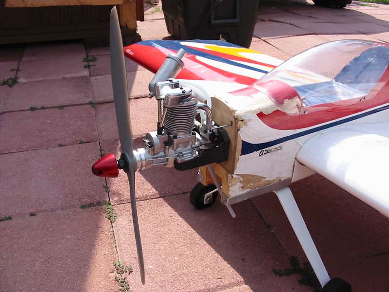

Here are the pics of the setup, Hitech 525MG on throttle, and both elevators. Hitech 645MG on rudder, Hitech 625MG's on ailerons. 6v reciever pack, stock fuel tank and tank location. 2 Oz. lead added to tail to balance.
Left side.
Right side.
Engine/silencer/mount, stock mount, just had to shape it with the dremel on the inside of the rails to fit the engine.

I mounted the engine as per instructions. No problem getting it to fit in the cowl. You don't even have to cut clearance holes in the bottom for the valve covers, but I probably will for cooling. The only problem is that the rear of the engine hits the motor mount screw on the upper left corner, so I had to use a countersink head screw for that side. Other than that, all works well. For servos, I went with what I had on hand: Futaba 3004s on the elevators, Hobbico CS-65s (Hitec 605 clones) on the ailerons, a Hitec 645MG on rudder, and a Futaba 148 on throttle.

Well, the modification wasn't by choice. When I came down at a nasty angle on a dead stick, the motor ripped the firewall out. I ended up replacing the firewall and had a clean slate to start with. If you want to redo yours, just take a dowl rod and some 30 min epoxy and knock out the blind nuts, fill the holes in and remount the motor. I lowered mine just a tad. I used to have a os 50sx on it and it vapor locked twice on me. I was scared the saito would do the same thing and I would damage the push rods so thats the reason I mounted it up right.
