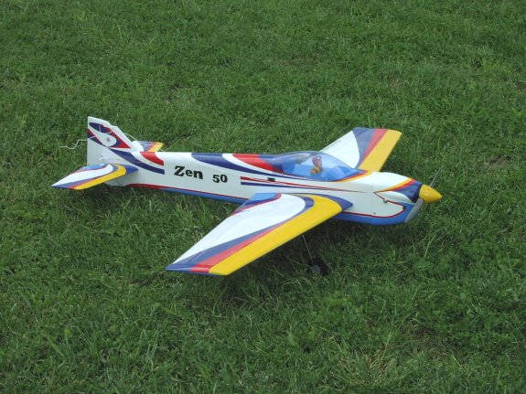

I did 3 test flights of my new Zen 50 today. I could not get over how well built that kit is. Everything goes together perfectly, and the construction/covering is better than I could do. On the first flight, I needed a little right trim on the aileron, and maybe a click or two of elevator. Otherwise she flew great and landed even better. The problem came when I started looping. Inside loops rolled a little to the left, but manageable. Outside loops rolled hard right, and it took a couple attempts to figure out how much left aileron I had to hold to keep the plane on track. According to my radio manual, if a plane rolls in different directions for the inside and outside loop, than one side of the elevator is moving more than the other. However, on the table, even with resistance from me, the two halves move exactly the same and are rock solid. My brother thinks he remembers reading that the rudder trim could be off (balanced out by the aileron), and that it shows up in the loops if it is. The wing is very stiff to stress and appears perfectly built. Any ideas?

Have you checked the lateral balance?

When the wing is off, it balances perfectly L and R. I have not tried balancing the entire plane, or carefully observing other manuvers yet to see if one tip needs a little weight, but I find that hard to believe....

Rick,
If you are using the split-Y elevator control rod, it may be that one of the Y is flexing more than the other under load. If this is the case than you may want to use the MK bellcrank to drive two elevator halves more accurately.
Also, you want to do the lateral balance with the wing on as the engine muffler position or equipment location in the fuse may cause one side to be heavier than the other.
Azhar

Have not had a plane yet that did not need a touch of weight in one of the wing tips to correct for lateral balance. Would never put one in the air without checking it.

Check the horizontal stabilizer to wing alignment; ie they are parallel, a visual should confirm that. If one wing tip is higher, then inserting some wing seating tape on that side of the wing seat will help.
When attaching the horizontal stabilizer to the fuselage in any plane where the stabilizer cutout is precut from the manufacturer, it is important that the stabilizer is attached with the wing fully seated and bolted down on the fuselage to check for elevator alignment. Even a few degrees out can have an exagerrated effect on perfomance. I found this the case with most similarly constructed arfs.

Thanks for the great suggestions. I will check the balance with the plane put together. Incidentally, the muffler is on the left side, the side that acts heavy during loops, so maybe that is the problem. The wing alignment with the stabilizer looks good. If it is off at all, it can't be more than 1 degree. Again, the worse rolling happens with outside loops, when the elevator rods are pulling, making it less likely in my mind that differential elevator movement is the problem, but I will keep it in mind.

If you already checked the elevator halves it almost certainly is the planes lateral balance. You said you checked the wing balance with it off the plane but you really need to check the lateral balance of the plane with the wing on. Ihave a kyosho cap that off the plane the wing balances perfect but for some reason had to add a ton of weight to the left wing tip for the plane to balance laterally. I found that quite odd but it does fly straight!

Wow, that muffler way out to the side sure has an effect! I finally was able to check my lateral balance, and it was off by quite a bit. I'm sure it is the muffler since everything else is symmetrical. It also explains why I needed right aileron trim on the first flight..., COOL! I can't wait to test fly it again Sunday (hope the weather will be good )
