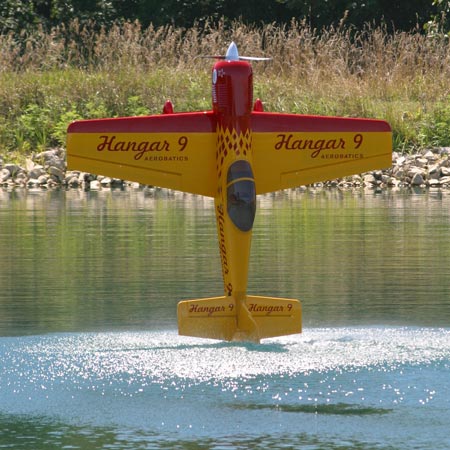

I see that all of you wanted me to get the ZDZ 80. Well i probably cant. Since i got the GT 80 for christmas. My parents said maybe down the road they will get me the ZDZ 80 and put the gt 80 on my stinger. I will let yall know how it turns out. Thanks for the advice.
All so what would be a good prop for the gt 80 and sukhoi.

a 24/10 for the gt80 . its a heavy engine that really lacks power for that size plane . for unlimited 3d a 100 110 is the tric pic for it . it will pull it out of a hover and that type of stuff . i power my planes on the extreme end of things so a little less that i think will be fine . i want to be able to flutter when i punch out of da hover those are a sweet flying plane i don't own one but have flown one waiting for the 50% when i find a big enough engine

Default RE: Sukoi 1/3 Scale????
Well, if they bought it all new, return the GT80, and buy a DA100 or a zdz80. I have the sukhoi zdz80 combo, and its sweet, but with a DA100, its an animal!! Ive also flown it with the gt80 and it will hover, but not much pull out power, I honestly think you will be dissapointed with that engine if your looking to 3D it.

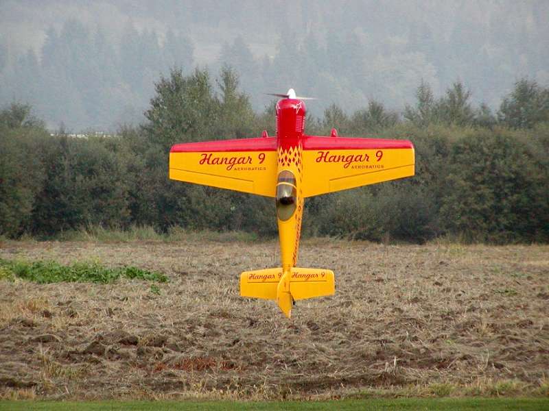

Im sorry sukhoi kid, but your 'research' was wrong. Where did you do this at? The ZDZ vibrates about like a big twin does, I have seen BME's that vibrate more. I totally understand your wanting to use what your parents gave you, and it will fly OK. But is not a good choice for 3D or pulling out of a hover with authority.

There is a HUGE difference between a GT80 and a ZDZ80! Like over 3hp! and the zdz is alot lighter and is cheaper. Anyway, if you want to get into extreme aerobatics, youll want to sell that thing. Its worth its most right now when its new. But, the plane will hover, but will not pull out of a hover with authority. But will still be fun to fly, unless your power hungry like all of us!

OK, just under 3HP, I was off, but that still is a HUGE difference! Check out the weight difference too!
Basic comparo
GT80=5.8hp, 7.69lbs, 24x8-10 - 22x8-10 propellers, $800
ZDZ80=8.5hp, 4.1lbs, 24 x 10-12, 26 x 10-12, 28 x 8 props, $715 w/muffler
DA100=9.8hp, 5.8lbs, 26x12, 27x10, 28x10 props, $1150 w/o mufflers
