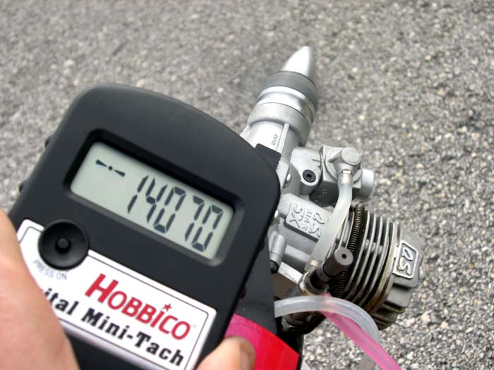

Your original question asks if the 50FX (do you mean SX) is enough to hover the Funtana (do you mean H9).
You can get a 1500rpm increase using the Rossi Pipe and the transition is instantaneously crisp.
The image depitcts top rpm w/ an APC 12.25x3.75 15% CoolPower using the Rossi Pipe.
I THINK this set-up should be enough to hover the Funtana at about 1/2 throttle.
