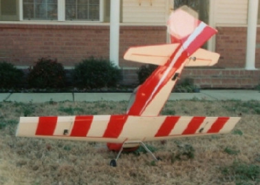

Here was my baby. Great Planes Cap 232 .40 wing span 58 1/2" total weight 5.75lbs. YS 63 for power, 600mh batt. pack. Hayes 10oz tank. JR Stan BB 517 on elevator, JR premium sport 531 on rudder, Hiteh 85 on throttle, Hitech 225 on alierons. Magnum spinner.
This plane bit the dust on maiden voyage. I bought this kit back in 2000, didn't built it until 2001. Come to fight out, the CG had an adjustment issue I didn't know about that wasn't in the manuel. I had my CG way to far aft. Also I didn't have enough alieron throw to correct the roll once it lifted off. I should have went by my instinct and used as much throw as I could get but I listened to the book, and I didn't have enouch. Plane is not repairable.

Here is the bottom.

I forgot to tell you how it crashed. I ranged checked it w/ and w/o motor running. All controls were working perfectly. Low rates were used according to manual.
I lined up on runway. Gave some throttle to start the take off, I got it up to 1/2 throttle gradually, I had plenty of airspeed, Pull a little on the elevator, and a slow climb out, a she rolled to the left, (no problem i'll add some right stick,) I added some right, she kept rolling to the left! (I added more right!!!!), she kept rolling!!!!!!!!!. I finally got her stopped inverted w/ full right stick. Needless to say I was complete lost. She was inverted, less than 10ft. off the deck full right stick, Since this was her maiden flight, she was headed toward the runway, I couldn't think fast enough, she whet it. (I guess that makes the differance between a good pilot and great pilot. All I had to do was add a little down to at least buy me a little more time. ) Lost the entire plane. except motor and servos.

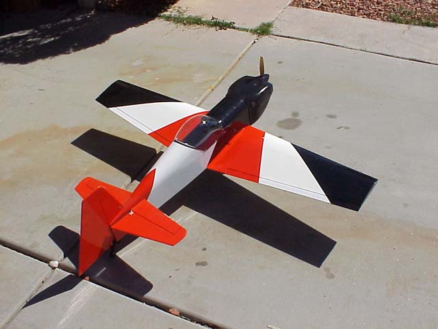

Heres my GP Cap. I have a OS 46 in it. It needs more power but I find it will 3D with a lot of effort.

I too have the GP Cap 232 and find it a very forgiving plane. Even at full throws (As per the book) I can bairly make it snap. OS 46 for power. It is one of my favorite planes. Lands super slow and is highly aerobatic. Sorry about your plane, Phil (Mesa, AZ)
