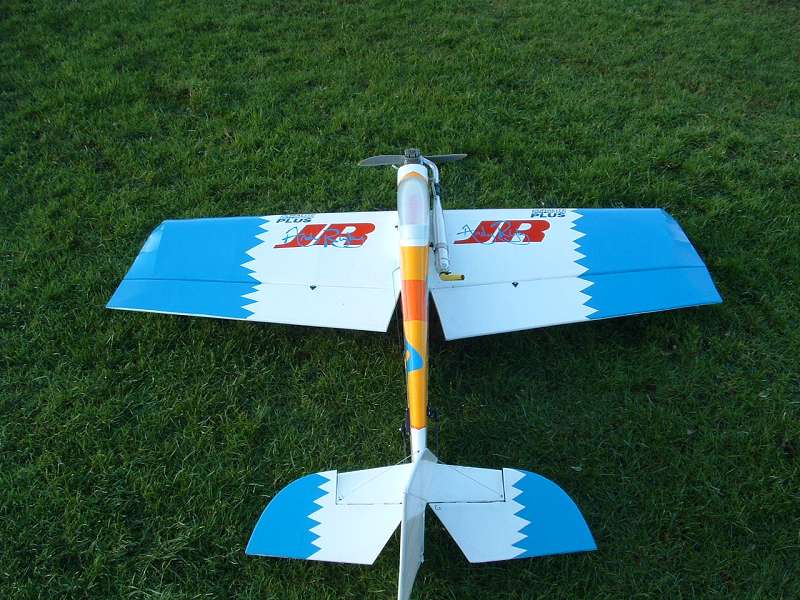

Well sort of. I really like this plane and after spending 4 months really putting in the hours, i decided to improve things! The fuslage is now very much like the ZN line synergy 90 3D. It is deeper than the original flip by around 30% also it is curved on the bottom like the synergy. Also it now has a removable belly pan again AKA synergy! the pipe now is hidden under the wing. I have also lightened the airframe quite a bit.
Overall all improvements have helped. It now holds KE very well without coupling, also its even better at 3D because its lighter.
Engine : OS 50SX with hatori 544 tuned pipe.
Servos : JR 591 all round with carbon 3mm torque rods and balls links
Radio : JR PCM 10X
Well go on, get that knife out and get modifying. You may just be pleased with the results, i have been.

On my flip it is the original fus modified. The wing has also been lightened (ribs cut out). The fus has bottom decking sheeted to give the extra depth. The front is moified like the synergy, the undercarrige sits inside the fus and the belly pan slots over the top. It is almost identical to the ZN line synergy 90 fus.
