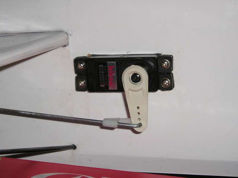

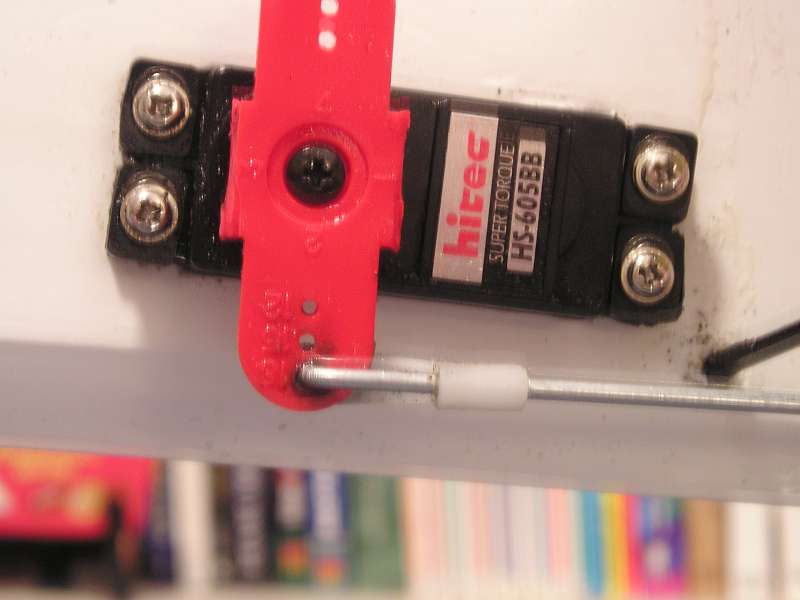

finaly got my camera working hitec 605 high torq is the best way to go and use some polly carbon methol servo arms here are some pictures. the white servo arm is an axis extender but the servo am itself is will give you the 3D throws you need to do extreem manuvers you want. good luck

o i see its an extra your mounting it on

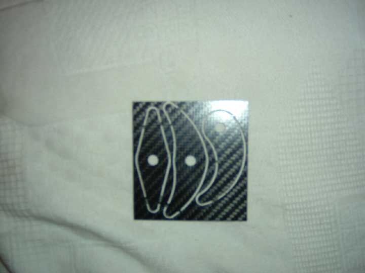

Old 02-26-2004 | 03:45 PM
Free-D-er's Avatar
Joined: Dec 2003
Posts: 50
From: Manchester, UNITED KINGDOM
Default RE: 1.5" servo arms
Carbon Copy in the UK will be bringing out some carbon 3D servo arms soon. They are CNC cut from carbon sheet.
