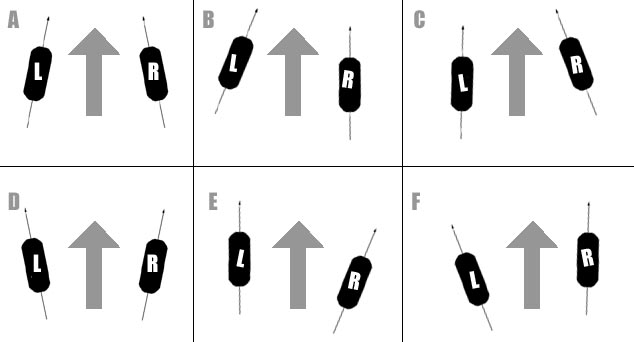

I'm getting ready to build some CF main gear for a few planes and was wondering what the optimum toe-in angle is. Anyone know? I was thinking three degrees on the right side and three degrees on the left side.

Toe-OUT on a gear will almost GUARANTEE ground looping! Look at the facts... Refer to the picture below. The top 3 segments show a plane with TOE-IN. The bottom 3 show TOE-OUT.
In frames A and D the angles of the wheels are even in relation to the direction of travel and therefore have equal drag.
Now, let's compare frames B and E. In frame B the nose of the plane has shifted slightly to the right. This causes the Left wheel to toe-in even more, while the Right wheel "Straightens out" with the direction of movement. this creates more drag on the Left wheel and less on the Right, causing the plane to want to return to a straight track. Whereas, in frame E, with the wheels Toe-out, as the nose drifts to the right, more drag is placed on the Right wheel, while less is placed on the Left wheel causing the plane to want to go further to the right, and creating a ground loop.
Keep your taildragger wheels SLIGHTLY toe-in. NEVER toe out.

Just a minute.... look at B, is the arrow the path of movement? Then you are crabbing on landing due to cross wind.... your left wheel would touch first due to the low wing being into the wind, when it touches the ground, you flip. Right? That's what I see... and have had happen too!!!! IMHO

Ok, let's look at "B". Yes, the arrow is the direction of travel, and you're right, in this position you're crabbing into a cross wind... which in this case, would be coming from the RIGHT. Low wing into the wind = RIGHT wheel touches first.

Oh yea, Don't get me wrong, The wheels in the pic are exaggerated for clarity. I'm just saying that if the wheels are going to toe one way or the other, you're better off having them toe-in than toe-out. I always set mine up so that they are ever so slightly toe-in, that way I know they're NOT toe-out.
