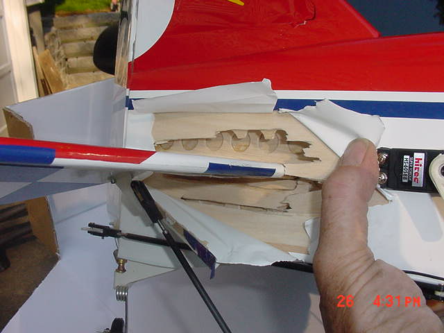

I had the same thing happen to me on its maiden flight. Right after takeoff at mid throttle I starting to make my first turn and the balsa supporting the horizontal stab at the fuselage broke apart.
They don’t fly very well without an elevator :>
I repaired the plane myself and added tail wires. I have flown it for a few seasons now without any other problems. Here’s a pics I took when it happened.

Sorry Richy, but looking the pic it was clearly your fault. The control horn setting is way too short - no mechanical advantage. It induced a very strong flutter and within a second it was broken. Many people use on small planes way too expensive servos, carbon rods, but forget about mechanical advantage. With the right servo and control setup this plane can fly with the cheapest standard servos. Even the strongest servos can be rendered useless by a poor mechanical setup. Horizon has some words on mechanical advantage.
http://www.horizonhobby.com/Explore/...ArticleID=1409

Hi TTR
You’re absolutely right. I learned the hard way on that one.

Looks like tail wires would be good insurance here.
