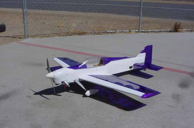

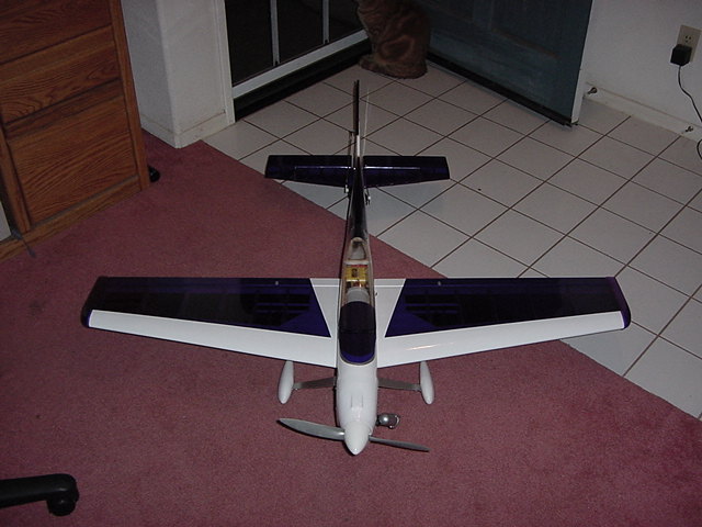

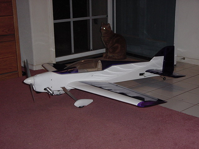

It's finally finished! Will fly it tomorrow. I'm so excited! Too bad the trans purple doesn't show up at night.

But do tell what the particulars are as far as radio gear and prop selection..I'm sure a lot of guys are highly interested!!
And what did you do on the wing tips..they look trans purple too...
Plane looks great! You did an excellent job.

Servos are all ht 425bb except throttle, 81. I used RC car paint on the wing tips, Candy Purple. Was going to do the canopy too but my airbrush is too fine and I couldn't get it even on that big of a surface. Used white car paint on the cowl also. It's designed to be used on the inside of clear lexan bodies and resists fuel. Got a 12x7 apc on the ys 63. 11.5k leaned out.

No mods yet, but I do have two pieces of 2" trailing edge stock thanks to ChuckAuger. I'll have bigger ailerons soon. Don't know the weight, only epoxy I used was joining the wing. Screwed up and used the 1.5mm sheeting for the turtle deck and bonnet so it might be lighter but those areas are weak and I must use extra care handling my model. When building, the thinnest sheeting is 1.5mm and is for the wings. The 2mm is for the turtle deck.

Hope you enjoy the aircraft as much as I do.. Cat looks p***ed off though!!!! let him out...
How did you attach the canopy, I screwed mine...

Canpoy is glued on and ultracote trim on the front edge. And Scott, going after I shower. Almost forgot, I did glass the wing joint, maybe added a half oz or so..

Great maiden flight! A few clicks of right aileron and off we go. Did a knife edge spin and some waterfalls. Didn't want to get too carried away, only 30 minutes on the engine. It's kinda plain, would love to have those graphics. I got the pdf files from the Pilot web site, just need to find a printer who will print on clear vinyl with ink thats fuel proof. Just don't really care to spend a whole lot.
