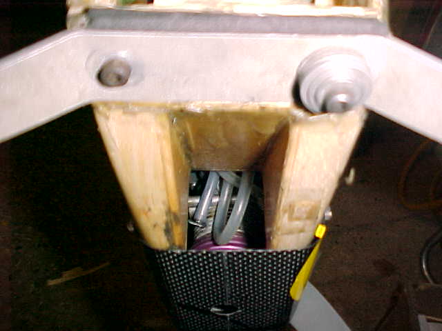

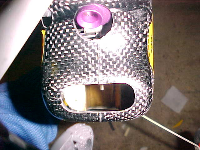

this is cut in my flips new carbon cowl. is this hole in the front big enough to cool my engine sufficiently? and is the hole at the back big enough to let all the hot air out?

Yes and No. The areas look fine but you may need to make a small baffle in the cowl to direct the air flow up towards the engine. As you have it the air flow is almost straight through and may not cool the engine enough. I have put 2 pics on to show what I mean, pic 1: the RED area I have added whould be the rough size of the baffle. pic 2: A line drawing (very rough) with a side elivation showing you what I mean.

cheers, what do you recon id make it from, just a bit of covered balso or maby some bit of carbon fiber?

Edible, measure the exit hole. Hypothetically, if it is 1 1/2" X 1 1/2" it is 3 square inches. For proper flow the entry hole must be 3 square inches. An alternative to a baffle would be if the entry hole is now bigger than the exit hole, then the increased air flow from the larger entrance now has a harder time escaping and will roll around inside the cowl reaching all areas. Joe

for optimum cooling the exit area needs to be 3 to 4 times the inlet area, this is something to do with the hot air within the cowl expanding and maybe surface friction within the cowl
The air must flow over the parts of the engine you want to cool, so the baffle is required

I would say that you will not have suffecient cooling. You must have airflow over the cooling fins. The cut out is too low. Now that it is there, you may have to add a baffle to the cowl to direct the airflow.

guys c'mon now! no fighting. Actually its a combination divergent duct and bernouli's principle. For the divergent duct this is what you have: Your entrance hole that is smaller then your exit hole. The air passing is through essentially a DIVERGENT duct. In a divergent duct, velocity of a fluid decreases, but pressure increase. so now you have a little "high" pressure in the cowl (actually its not much but enough) This coupled with the pressure drop from the curve of the cowl speeding up the air causes a suction that pulls air through the cowl while in flight.

Ill go and make a baffle (if thats wot that bit of balsa is?!?!) and glue it in with a bit of epoxy then ill get some photos of it in the air tommorow if the wethers ok.

o well, too late. Done it and it covered red lol. Never mind. Tho im really pi$$ed off cos i mucked up the exaust cut out and its got a big hole there now[:@]

"By increasing the ENTRY hole to a larger dimension than the EXIT hole it is now a form of baffle where the increased CFM now takes longer to escape and is forced to circulate inside the cowl."
I agree. However, this is undesireable in our planes. The longer the air stays inside the cowl, the hotter it will get. The exit hole should be at least 3 times the size of the entrance hole. This will ensure that the air does NOT dam up and circulate inside the cowl.

Gentlemen, when you increase the exit area, the speed of the inlet air increases. What happens is that when the entrance is the same as the exit, you will reach a particular speed when the pressure inside will increase. This increased resistance keeps the inlet speed down to the exit speed. Increasing the exit area, will decrease the pressure and increase the inlet speed.

all the builders around here use 2-3 times the size of entry. we figure it create's a kind of "Venturi" effect. which is an increase of airspeed though the cowl.

Increasing the speed of the air will increase the temp of the air, this application requires cool/cold air to keep the engine within working tolerences. A 1 to 1or1.5 entry to exit ratio will keep your engine within those tolerences set by the manufacturer. In edible_engine's case it is more to do with the directing of the air flow rather than increaseing the air flow.

plain and simple guys 1 in 3 out and thats it - best
